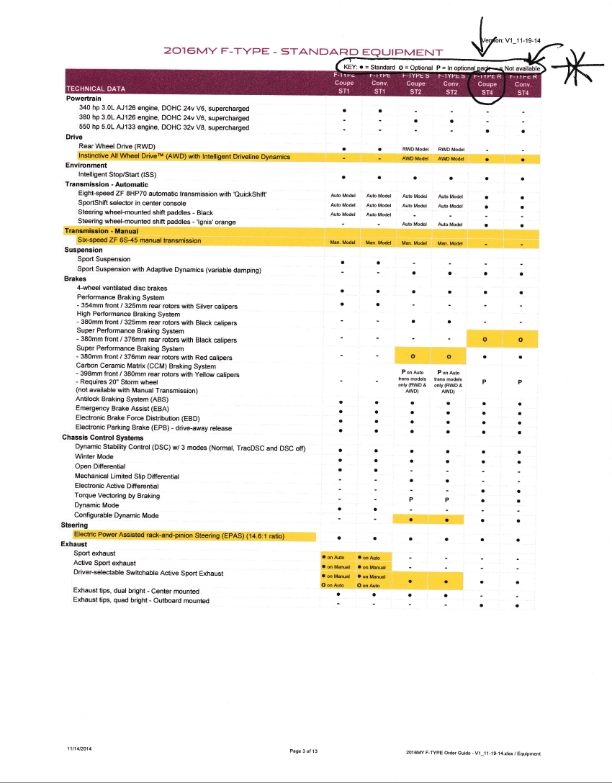

I don't think it matters now... turns out that the six-speed box in the F-Type is the S6-45, which is only rated to 470Nm...apparently...so for the money you'd be better off trying to find a secondhand S6-53 from an S-Type...
