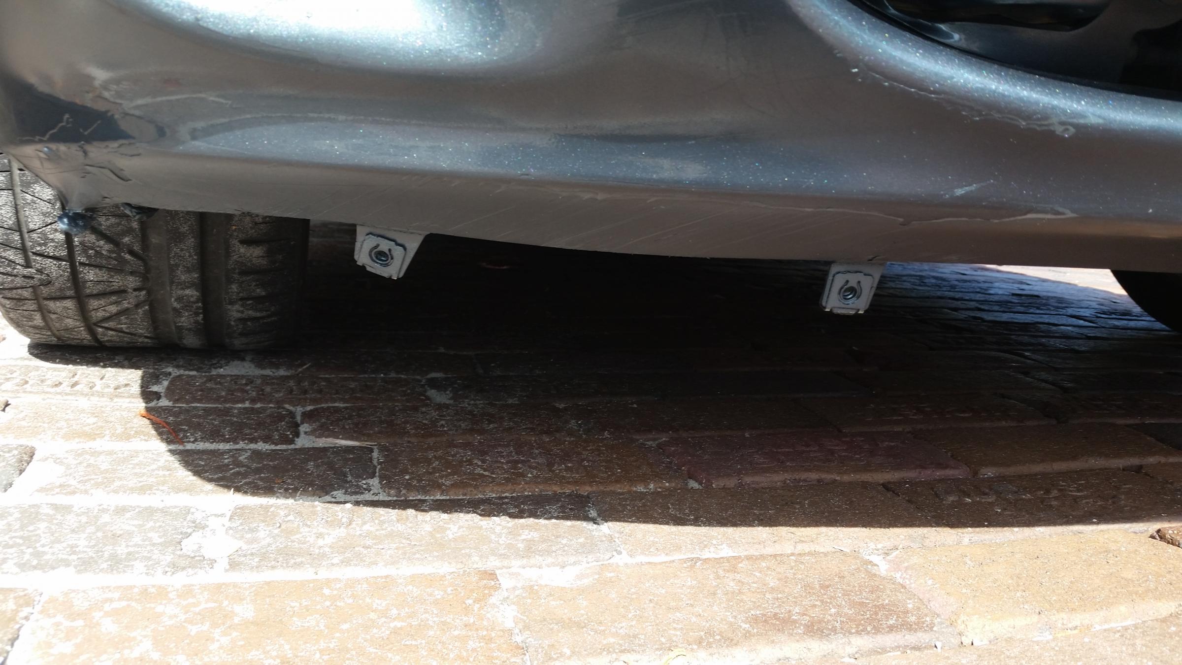

here are some photos of the underside of my bumper as you can see I have 6 posts which it appears something attaches to them this boiler I bought only has three posts so it certainly isn't the right one my question is what goes on these posts?

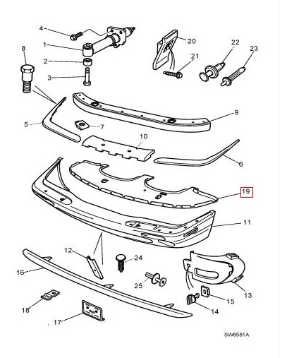

The 'posts' on the Front Bumper (item 11) are the attachment points for the black plastic Undertray (item 19):
The Undertray has two functions:
1. strengthens the Front Bumper by making it a box section
2. restricts airflow under the bumper forcing more air through the radiator and assisting cooling

it is the item number 16 in the pic above provided by Graham, it's not a spoiler.

it's a lower grill blade. your car already has it.

Item 16 is described as a Radiator Grille Vane in the Parts Catalogue and is available in Chrome or Primer.

Also known as the "splitter."
