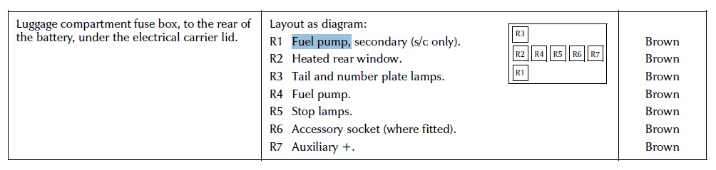

It could be a bad relay. The XJR (supercharged version)has 2 relays - one for the primary fuel pump and one for the secondary fuel pump.
Look at this JPEG showing the fusebox in trunk:
Relay for Secondary pump (SC only) is R1, Relay for Primary pump is R4.
