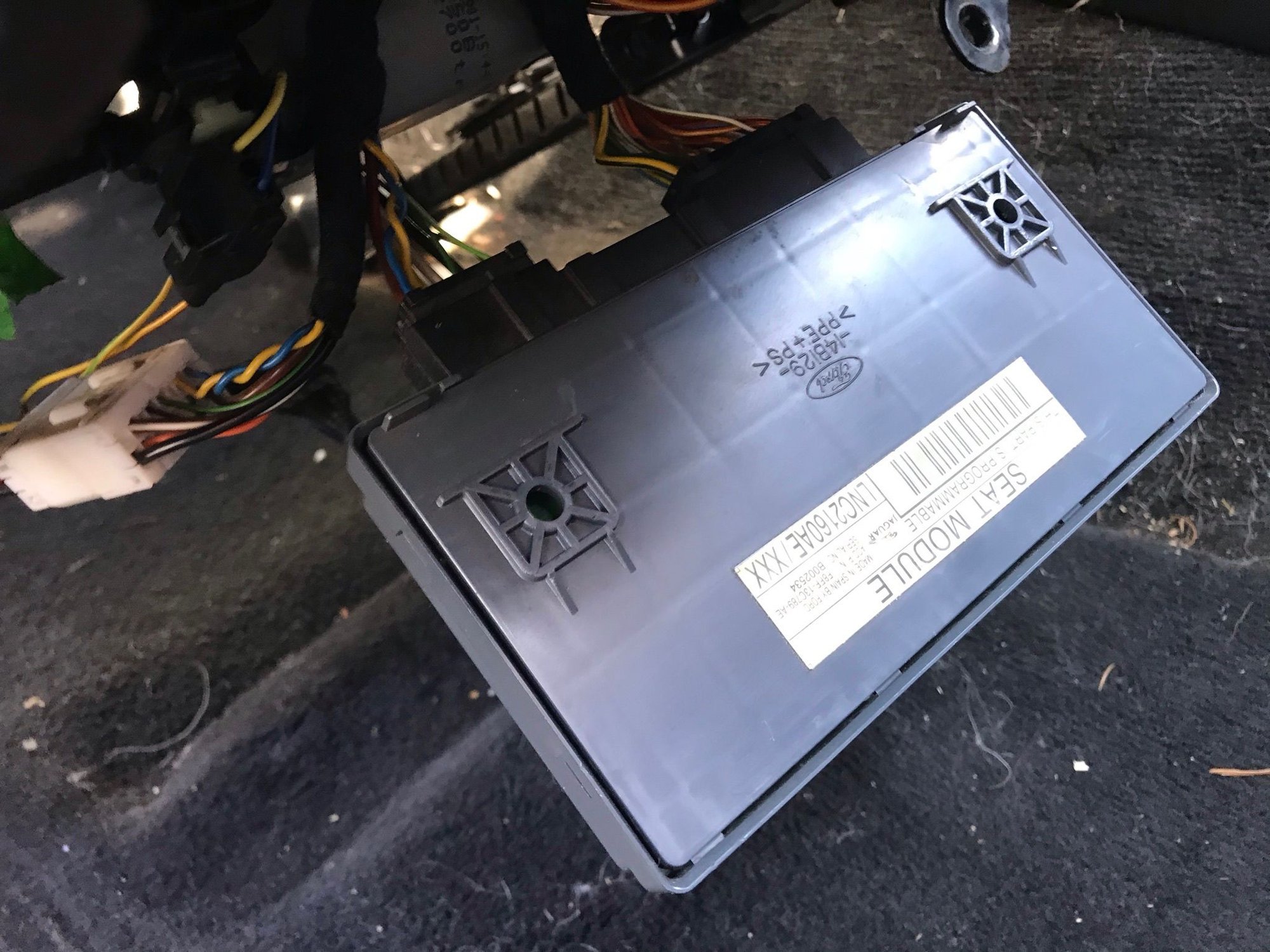

So I swapped the modules. The driver seat goes up and down. Now that the passenger seat will only go up. So the motor was good the cable was good But the module appears to be bad is that specific to this car or could I get one out of a donor vehicles?

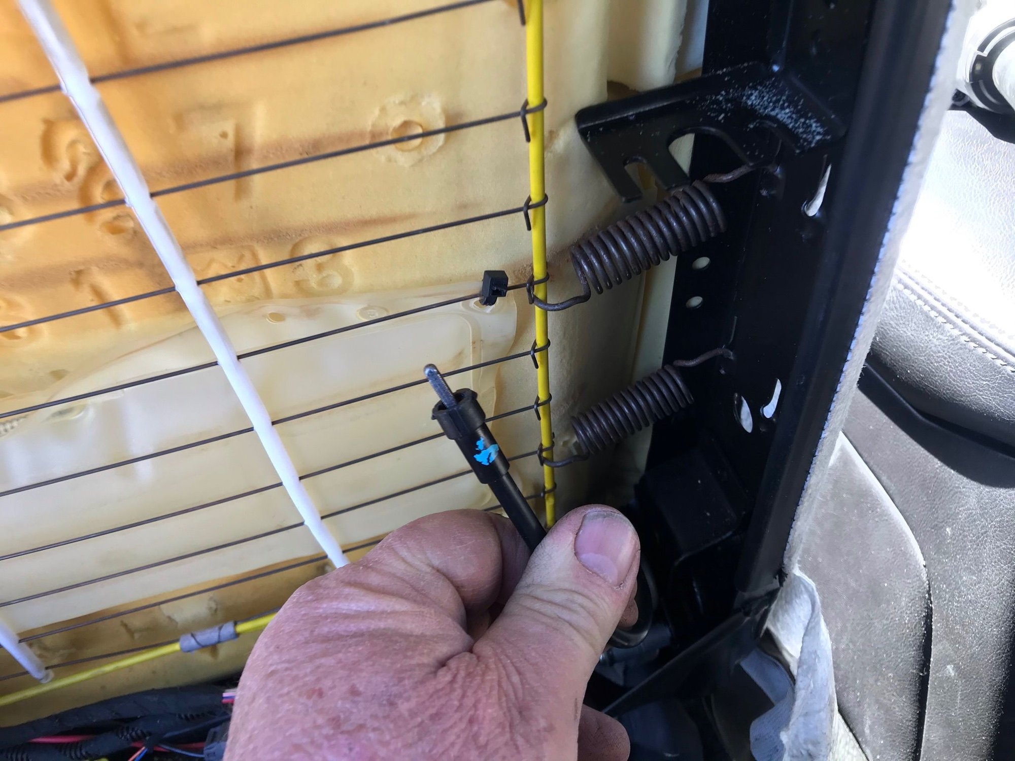

This is the module and a picture of the cable that goes to the drive motor this is where the drill motor hooked up it would raise or lower the seat manually

Look in the boot for the VCATS label and see the suffix for the XXX in the part number.

I pulled it out of the blue car and I put it on a silver car The guru in Vancouver said that they were not specific to the car are used another one out of the same year and it’s working fine now. Another one of those times Sure nice to have a parts car
