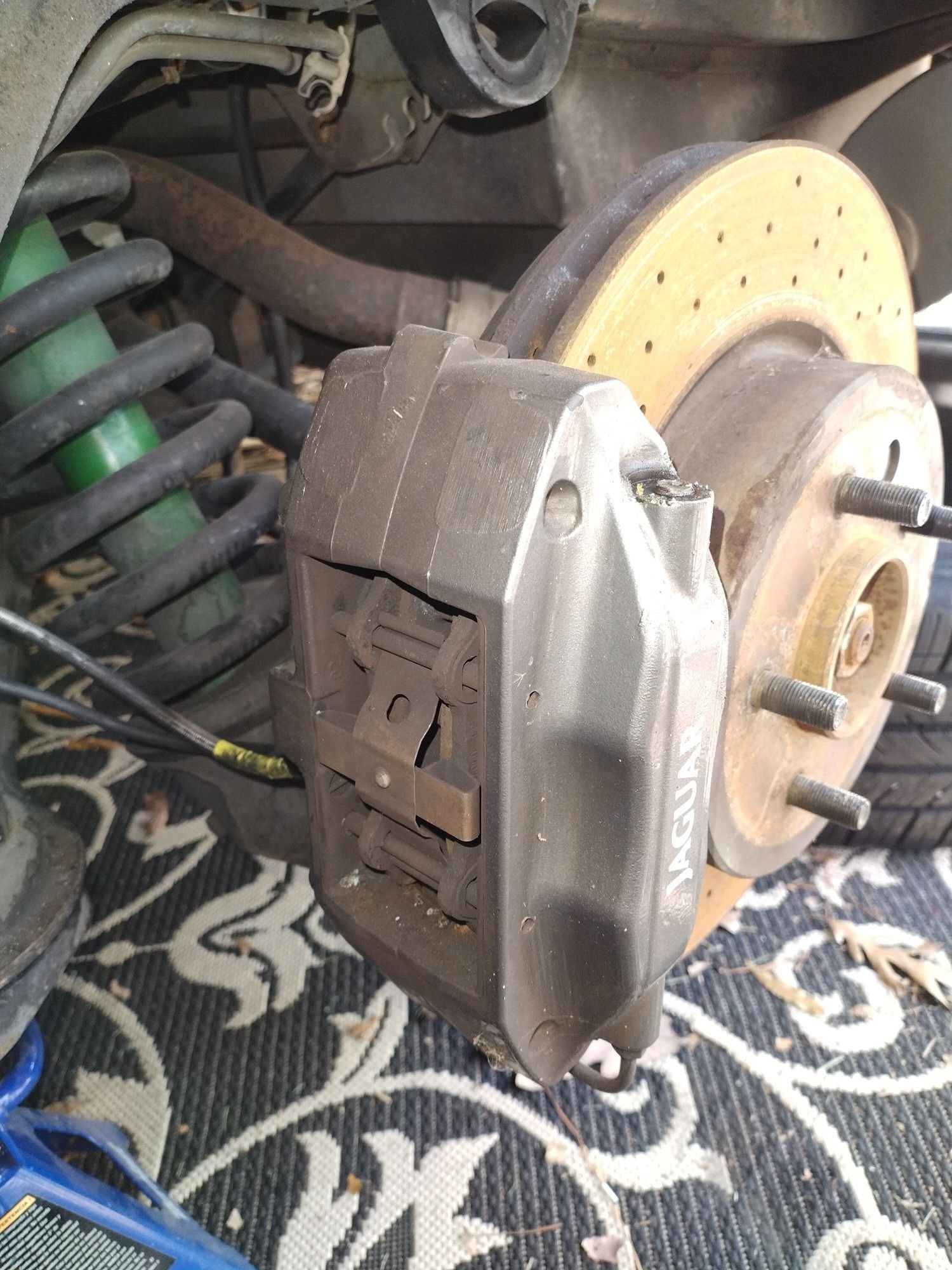

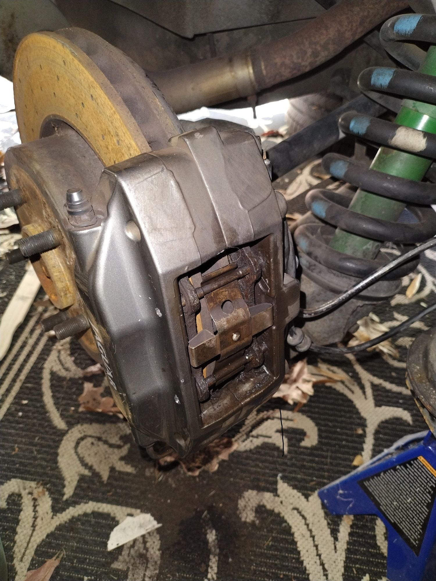

Here is a couple of shots of the type of brake calipers I have. The drivers side (US) seems to be frozen solid. I started the other side (passenger - US) and the pins came out. Not smoothly, but fairly gentle persuasion.
Gentle persuasion worked on these retaining pins
Retaining pins stuck?

OK, that is indeed a system I have not seen before. But what ixfn wrote above makes sense.
I read it as pushing onto the centre of that metal bracket WHILE sliding the pins out, as a step in the pins prevents them to come out without pressing onto the bracket (which is how the system hold together in the first place).
As I wrote: I have never seen that system before, but this is what I would do after I have seen your picture.

Thanks very much for the replies, guys. I did get one set of pins out quite easily. The other set is still fighting me. Much soaking in penetrant going on right now. On the set that came out I did follow the advice and was able to push in the spring which seems to have helped. As you can see from the picture, the reason why I'm doing these at all is due to the shop who busted off two of the bleeder screws!
I think my next step is to try to twist the pins loose.
