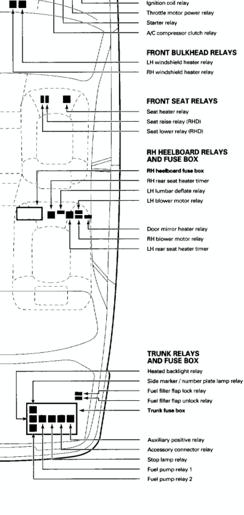

Wait, you removed the relay and the brake lights are still on? Lets make sure you removed the correct relay, the one you want is in the trunk in the cubby between the battery and the rear of the trunk. Looks like a T on its side. The stop light relay is the third one in the row across. Pull that and see if your brake lights are still on. I'm hoping you maybe pulled the wrong one and that your stop lamp relay is shorted. If this does turn the lights off, try swapping in the one for the rear window defroster (heated backlight) and see if your brake lamps work properly.

Before you start digging into the SLCM, pull both brake light bulbs and make sure everything is ok with them first. I’ve seen all kinds of weird crap with misinstalled bulbs, completely wrong bulbs, water intrusion, etc.
Have you spilled any fluid in the J gate or performed any work in or under the J gate recently? The reason I bring it up is because of the shift interlock comment you made earlier.
The gearshift interlock solenoid gets its power from the BPM. I wonder if the BPM is shorted to power and sending power to the interlock solenoid and SLCM for the brake light circuit when you turn the key on?

BPM’s and SLCM’s are the two most common failures on these cars. I’m not saying to replace one or both but, just keep that in mind. The 3rd brake light operates via a stop lamp relay in the trunk fuse box. Relay #5 and #8 fuse 10am.
