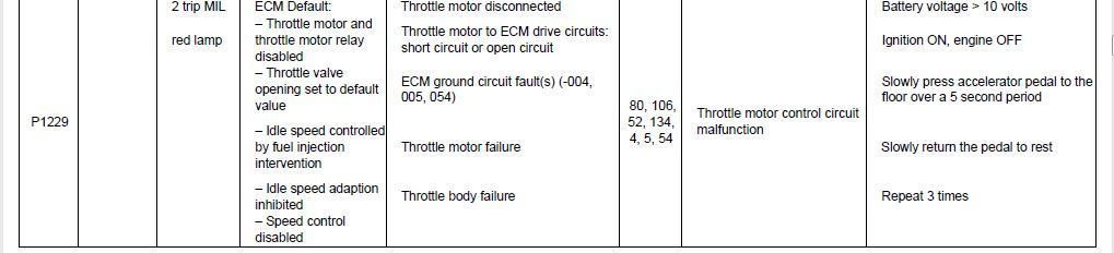

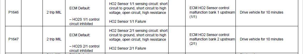

It is highly unlikely that a leaking camshaft (valve) cover gasket could cause your Restricted Performance or the DTCs you scanned, with the possible exception of the P0328, if oil has leaked onto the knock sensors. Also be aware that in addition to the Powertrain (P-prefix) codes that generic OBDII scan tools can read, your car probably also has stored Network (U-prefix) DTCs and possibly Chassis (C-prefix) and Body (B-prefix) DTCs that can only be read by Jaguar-dealer-level tools or high-end third-party tools.
My guess is that the most obvious causes of your Restricted Performance are the P0328 and P1229. Here are the definitions and possible causes of your Powertrain DTCs:
P1601 does not show up in any of my X308 or X350 Diagnostic Trouble Codes Summaries manuals, so that may be a fluke. I'm attaching one of the more complete manuals for you.
