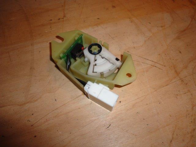

Well, I installed a new brake light switch and it cured the problem.
Switch consists of two micro switches actuated by a rotating cam. Cam moves by a pin welded to the brake pedal.
Check engine light was solved by replacing the check valve under the hood(bonnet)
