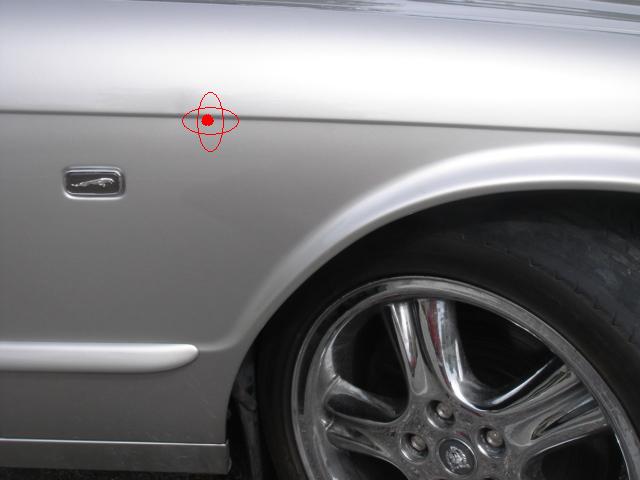

Exclamation How to unlock your hood if latch gives out.
OK ALL YOU NEED IS A flat head screwdriver and PLIERS.
first you will need to remove the inner liner use the pliers to pop out the pins,
now the picture I have of the side of the car i have showing is where your aiming at.once you remove the liner
the next set of pictures is once your under the fender....i didnt remove the wheel I just turn the steering wheel all the way to the right.."trust me its easy" now where I have circled you need to pry the putty and sheet metal it will open just take your time open with a screwdriver you need to open the gap so you can have enough leverage to reach in and pop the latch.. now to pop the latch you will need to pop it by unlocking by making the latch go towards the rear of the car (if you use a hanger youll find exactly where the spring is i found it easer to fish around that way rather than busting up my hands)
once you find the spring you are there..now use the flat head and to pop the latch like i described it before it will take a few times but you will get..
after you do it once you will do it every time its that easy.
replace cables and your golden!
