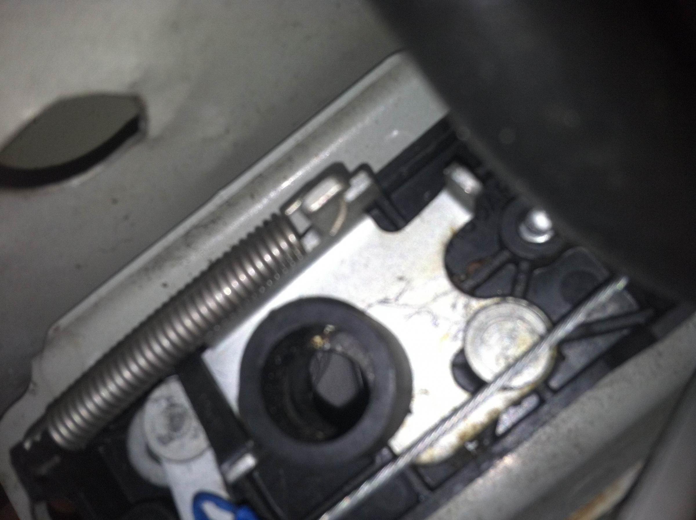

Jimmycruz -
In your pictures, is that the view looking UP? (I am presuming so). It's a bit hard to tell what Jag was doing there, structurally. Is that a piece of sheet metal that is only held on by putty and can be removed, or is it one that you bend out of the way, and later bend back? Would it make any sense to cut away some of this sheet metal cleanly, and then form up a patch/cover for it afterwards?
Also, looking at the latches, it's a bit hard to see how they can fail. If the latch itself gets bound up with dirt and gunk, I would think that you just wouldn't be able to pull the release lever. But evidently, it might not be a bad idea to clean the latches out every so often and make sure they are well lubricated.

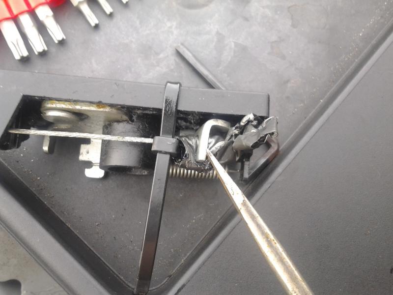

@suzjag - if only the leadhead is gone, and you can still get hold of the steel inner cable? with a good pair of gripper type pliers pull it to release the bonnet. You'll pull an inch, and hear the bonnet pop - repeat for the other side. You might need a new pull, certainly a new cable, it's an easy job if you're ok working on cars.

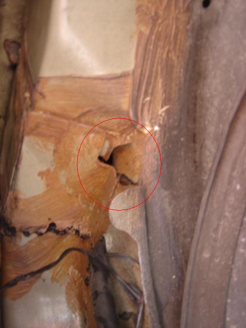

Exclamation i have some pictures that might help.
I have too been here...
But it is easier than you think once you do it ..
now the explanation above does help..but like most individuals such as myself ..I need to visualize what I am searching for...**ATTENTION DISCONNECT BATTERY FIRST!**
Ok 1st pic is me pointing in the general area that your going to be focusing on once you pull back the liner.
if you search around you will notice a seam of some sort.i used a long screwdriver to help with this project.
in the 2nd pic you notice a opening ....Now that is where the screw driver will end up being once your pry yourself threw.
now the 3rd pic kinda just shows what exactly you be doing once your fishing around..you wanna pull it toward the cabin..give it a few tries and youll get it good luck to my fellow JF friends.
*** update on the last photo i just uploaded you notice a opening in the body ladies and gents that's your sweet spot once you get in past the prying/drilling of the sheet metal.....
i put this on so you have a visual of where you would be sticking your screw driver when poking around " notice the lever "***
i put 2 more pics up but the one from underneath is where you pry through...just work it enough to get a screw driver in.be nice to your cat..
THIS WILL HELP DO NOT GO TO A DEALER OR SOME JOE-SHMO!! SAVE YOUR SELF MUCHO $$$$$$...ITS VERY EASY!! JUST be sure to thank me on JF it makes me feel good i helped a poor soul out plus i believe in karma !... good luck!

Originally Posted by jimmycruz99xjr
OK ALL YOU NEED IS A flat head screwdriver and PLIERS.
first you will need to remove the inner liner use the pliers to pop out the pins,
now the picture I have of the side of the car i have showing is where your aiming at.once you remove the liner
the next set of pictures is once your under the fender....i didnt remove the wheel I just turn the steering wheel all the way to the right.."trust me its easy" now where I have circled you need to pry the putty and sheet metal it will open just take your time open with a screwdriver you need to open the gap so you can have enough leverage to reach in and pop the latch.. now to pop the latch you will need to pop it by unlocking by making the latch go towards the rear of the car (if you use a hanger youll find exactly where the spring is i found it easer to fish around that way rather than busting up my hands)
once you find the spring you are there..now use the flat head and to pop the latch like i described it before it will take a few times but you will get..
after you do it once you will do it every time its that easy.
replace cables and your golden!

I'm about to attemp the passenger side hood latch repair... drilling as a last resort after trying everything mentioned in this thread...
The step by step instructions posted by Sparkenzap, the pics posted by jimmycruz99xjr and the post by jbrinkley confirming it works is all extremely helpful... however, what I would greatly appreciate before proceeding are more pics as referenced in jbrinkley's repost in Feb 2, 2012, of jimmycruz99xjr's pics from a post that may have been outside of this thread...
Please repost or email directly to me at vzr@aol.com... please enter Jag Hood Latch in subject line if emailing.
