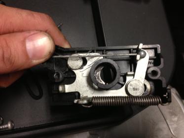

Removed the hood and pin was still stuck, finally, held hood up in air while one of us banged on the spring with a large screw driver and hammer.
Finally, it came loose. A piece of plastic had broken off the latch and jammed intself in there.
Caused by idiots slamming hood whille closing it.
Had to move the hood around to many positions before it turned loose.

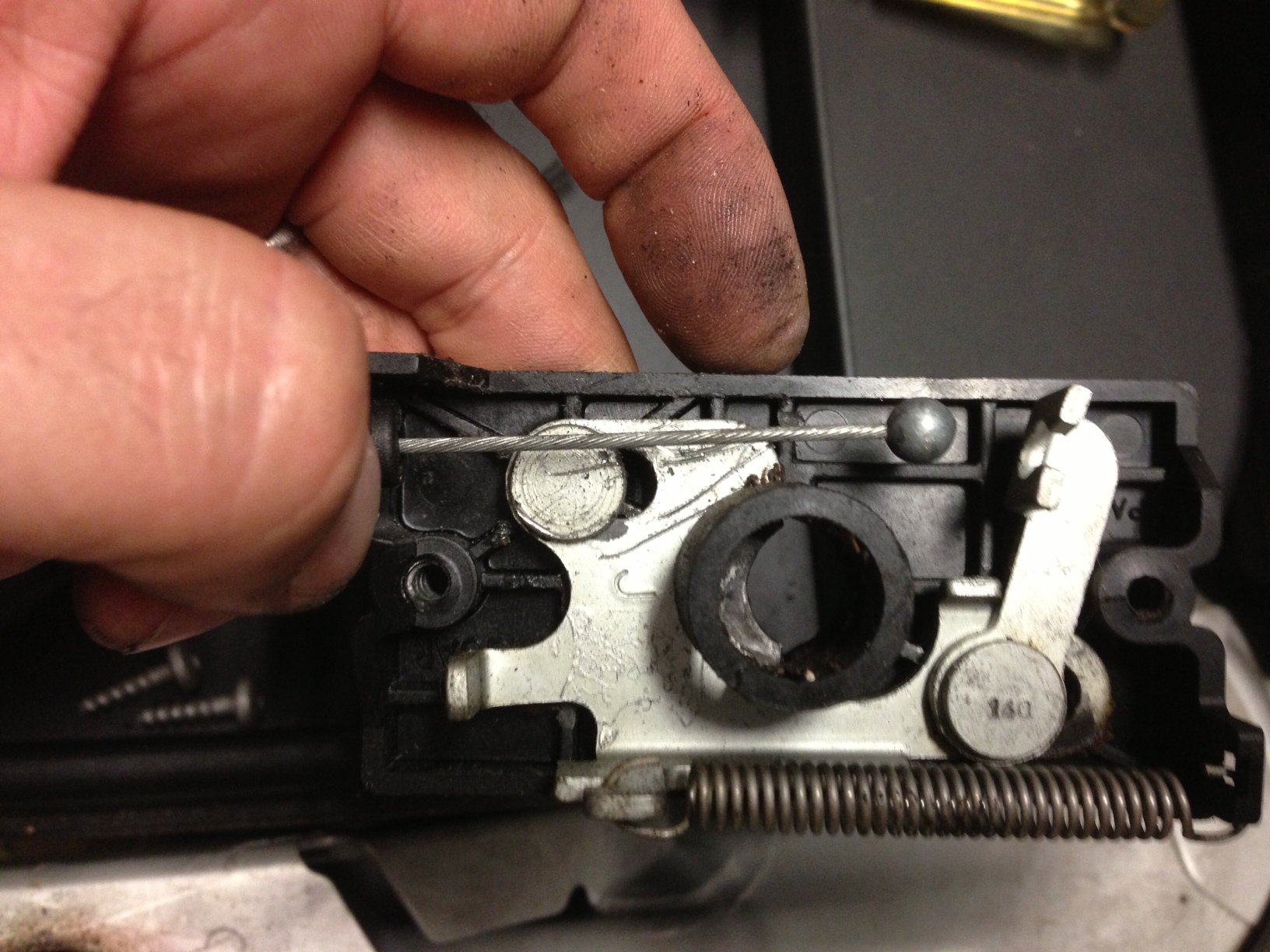

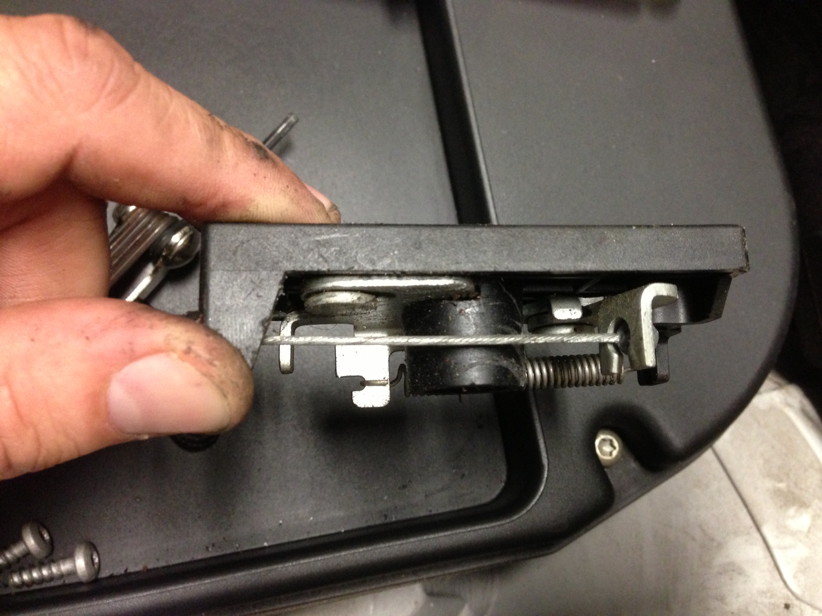

I had to do this a few weeks ago and I did NOT have to drill a hole. It does take some time and patience to get it. I read all the posts about where and how to poke and prod and after about 20 minutes of fiddling it finally popped open. I used a 8 inch phillips screw driver and a flashlight.

Original post was for a '99 XJR hood release, so the area to prod should be in the same general area for '01 XJ8, correct?
I saw a small opening following back curve of the wheel well and going toward the rear but the screw driving would only go up in this little crack but mostly everybody thats got it open said they were placing the screw driver or rod almost perpendicular. So then I drill some wholes but still not sure if I'm in the right area?
You can see the crack I'm talking about in most of the photos especially in pic 8 & 9. Also I could some wires in that crack area but again the screw driver seem to go only up...?

Comparing these to jimmycruz99xjr's photos below. The little crack opening is the right area, What do you all think? And how to get the screwdriver to go more perpendicular or sideways in this crack instead of straight up when proding around to release the latch???

If helps anybody with this problem in the future, I found it easier to pop the hood open by placing a flat head at the back of the latch and moving it to release the bonnet rather than the front of the latch (where the end of the cable is).

3. I see the spring end and the end is facing the rear of the car
Should I be pushing this spring end or something else
