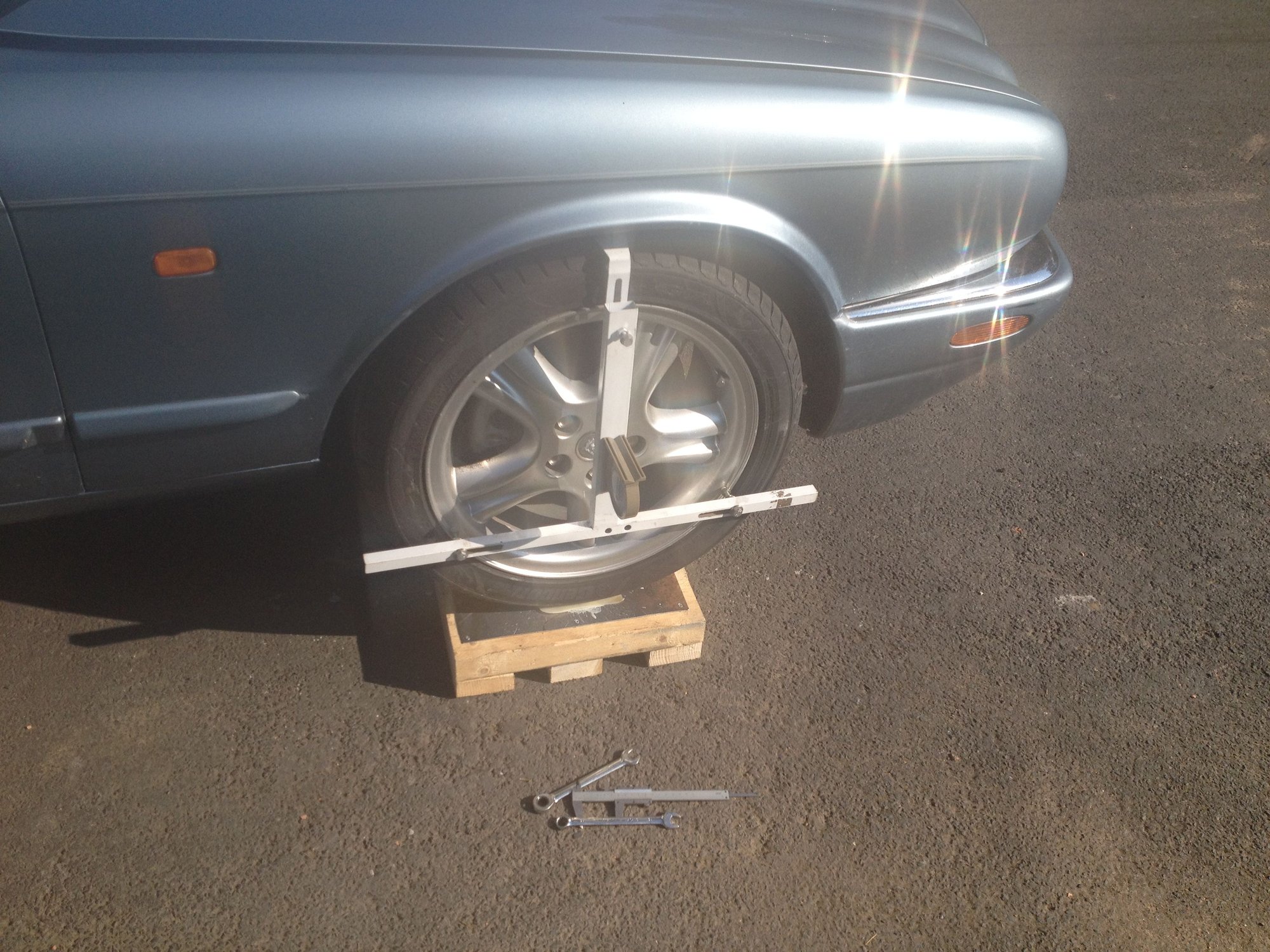

Default Diy alignment
So tried finding someone competent to set my front end up but not impressed with the mumbling I was hearing !, so made my own gauges and stands I already have a diy laser tracking tool and got toe perfect(.05) toe in, but struggled with camber!, only to find a worn cam plate (have you seen the price of those!, ). Looks like the we alder coming out again! Ha ho.
