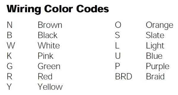

There are no fuses that would cause the problem you are having. In addition to the connector into the amplifier (I presume you mean the amplifier in the boot/trunk meaning you have a Premium system), there are also in-line connectors for the speaker wires - IC3 (12-way) and four 12-way connectors (CA10, CA12, CA14 and CA16; these are at the gaiters for the door wiring loom going into the body posts) - see the diagram attached.
However, I suggest you do the following checks: 1) unplug the connector from the amplifier; 2) Identify the pairs of wires (coming out of the connector) which go to your non-working speakers based on the colour codes shown on the diagram (for example, YR and YU (yellow/red and yellow/blue) go to the Left Front door speaker, etc.); 3) touch repeatedly a 1.5 V battery to each pair of the speaker wires and listen for crackling from the speakers.
If you hear crackling, the problem is in the amplifier. If you don't, the problem is either in the speakers themselves or in the mentioned in-line connectors.
