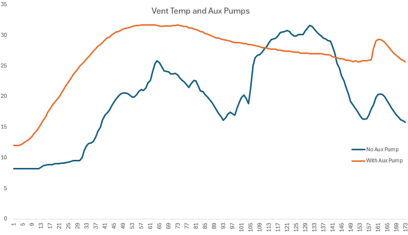

Finally had a chance to run tests.
It seems you can run without an aux pump (and the annoyingly loud whine).
I tried disconnecting and going for a drive in the morning.
The heater still works however it takes longer to heat up and
varies with engine speed. The drives was approx 30 minutes with speeds mostly around 80km/h with some 60 km/h and few
traffice lights.
The same run later with the aux pump connected shows the even ramp of temp and much more stable pattern which is to be expected.
Temperatures show are at the right hand vent. Fan speed was 2 bars, temp was set to 22 degrees.
Now to find a replacement pump .....
