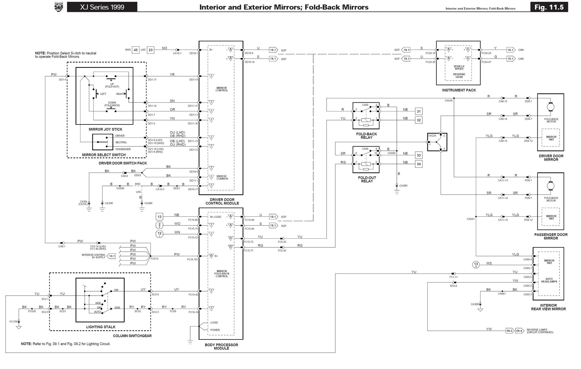

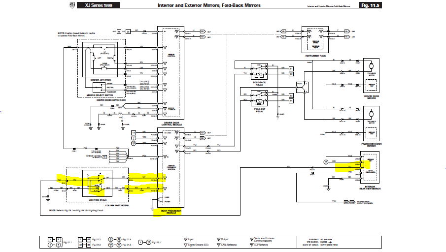

Old Mar 23, 2022 | 08:14 PM
Parker 7's Avatar
Joined: Aug 2021
Posts: 4,686
Likes: 1,327
From: Kansas City
A cleaner and bigger picture to work with
CA55 pin 5 should be a feeler voltage of B + value
This will be the same as FC15 pin 16 on page 122 of your 99 wiring guide
CA55 pin 3 should be a ground
CA55 pin 2 researching , your security lock control unit gets involved on this wire , have you unplugged it and tested the auto light feature ?
this can be seen on page 56 of your 99 wiring guide as the Yellow/ White wire at BT1 pin 5
It might involve a Hard Reset of the SLCM with some precautions that others with this model would know about
This would be before changing any parts
You can remove the reverse light bulbs and see if that makes a difference
