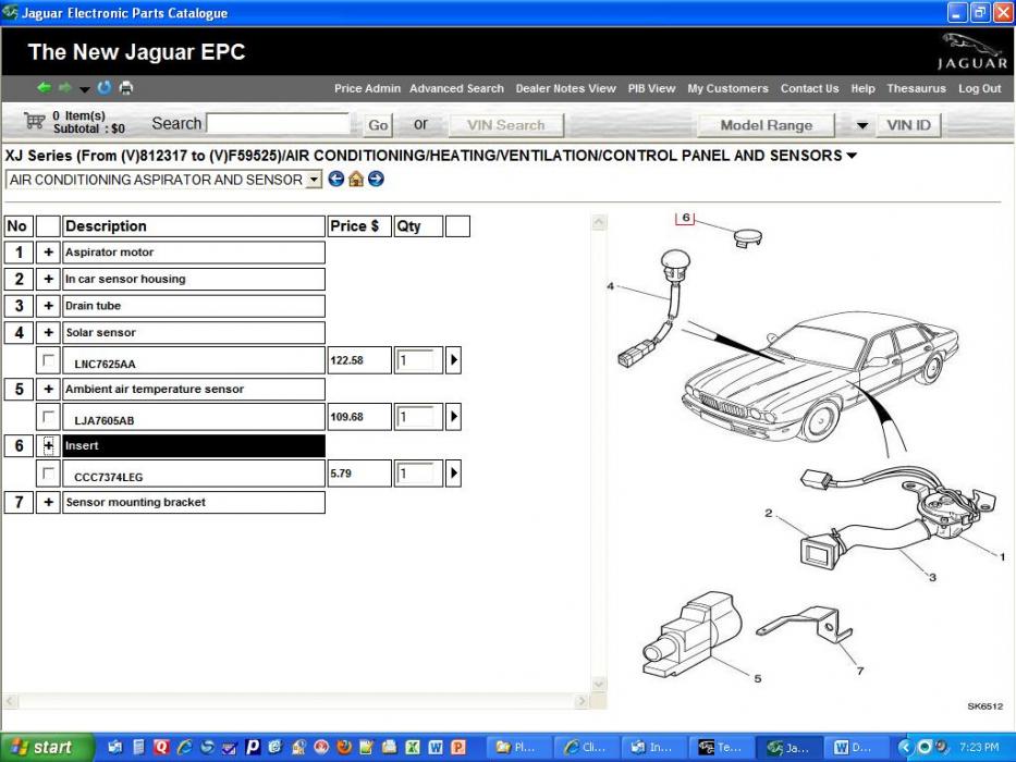

Hi
I looked up the climate control part numbers in Jaguar Electronic Parts Catalog (JEPC).
Here is a JPEC screen shot:
Look at #6 part description is Insert

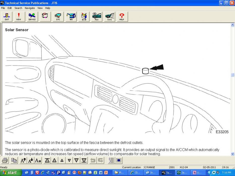

Also found this page in JTIS 21 CD on Solar Sensor located on top of dashboard/
Here is the screen shot of it:

You might do a parts search on the internet using the part numbers shown in the screen shot of the JEPC page. It might give more information and views of these parts.
Jim Lombardi
