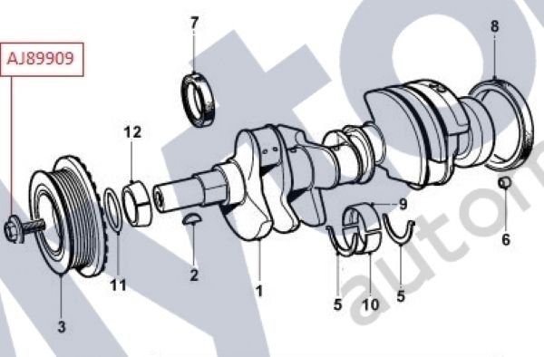

Originally Posted by Peter_of_Australia
Oddly, I did have the same issue with the crank damper (=balancer = crank pulley). Used the puller, applied lots of force, but it would not budge, Of course I did use WD40, then more and more and more. Nothing. The I completely removed puller and put it on again from scratch - doing nothing different - and this time it worked. I have to assume it is that special spliced ring between bold and pulley, which plays funny bugger and blocks any movement, if moody.
That is actually the way how the damper is removed. Apply force with puller, release, knock the damper back (plastic hammer), apply force, release etc. and it gets loose after a few cycles. This is because of the spliced ring's (collet) orientation - the harder you pull the damper, the more it wedges/jams onto the collet so you have to do the pull-release cycles to loosen the lock. The diagram below shows the collet (#12) but it is wrongly placed and oriented; it should be flipped 180 deg. and positioned in front of the damper, not behind.

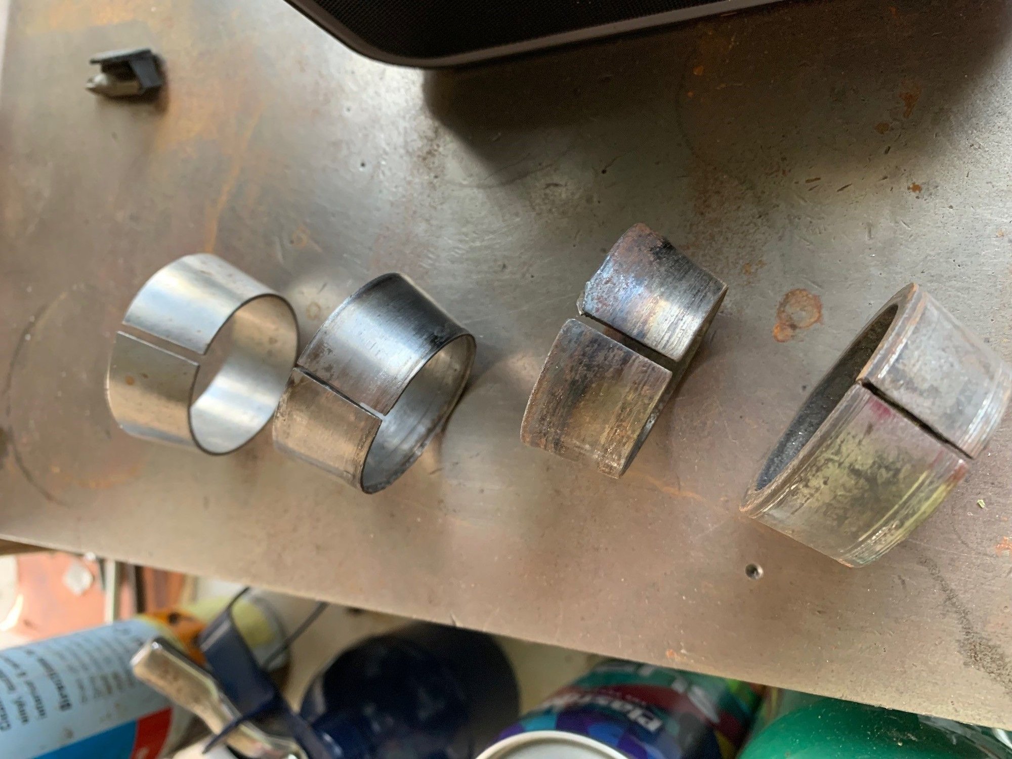

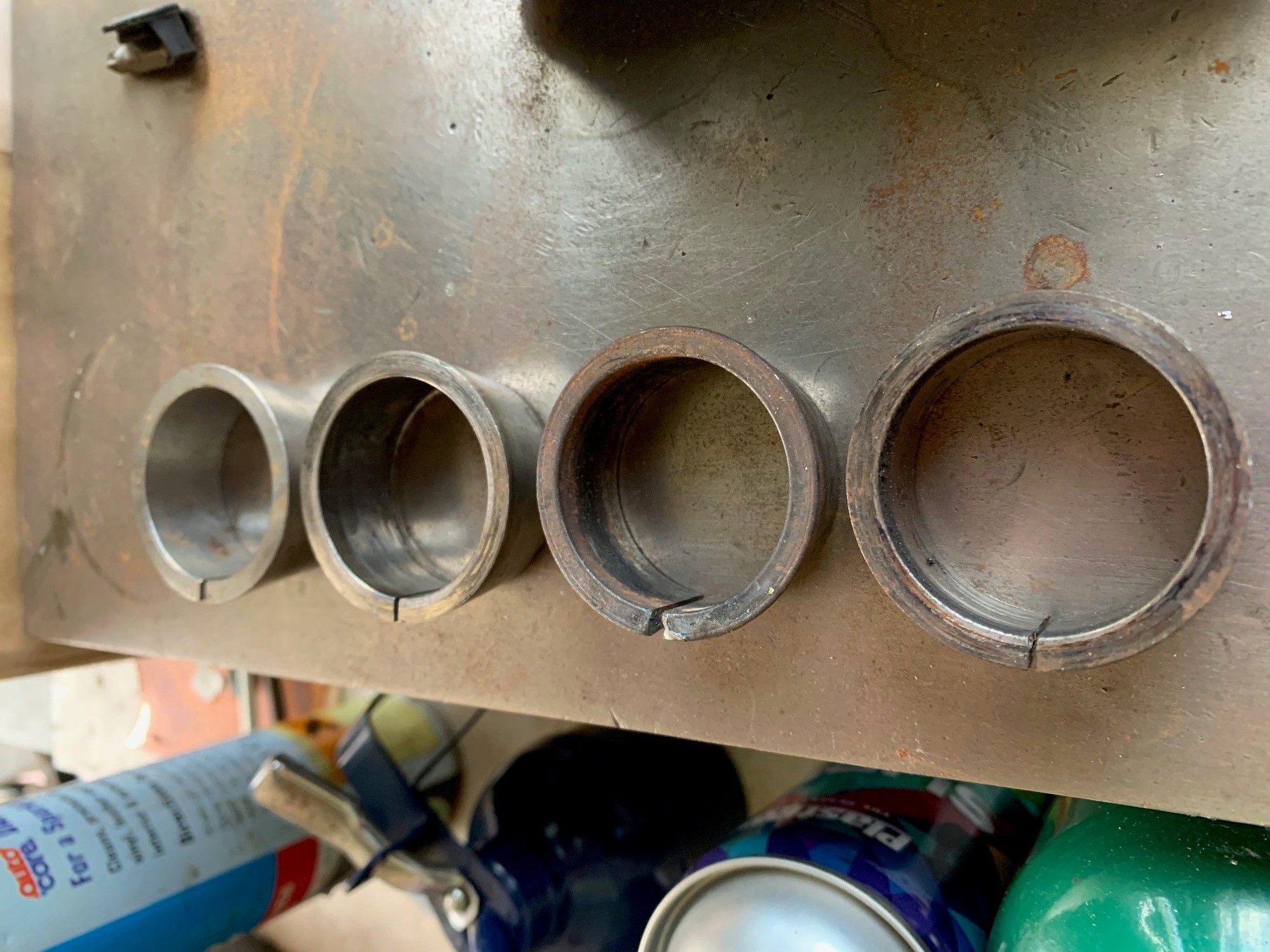

The cone is a vital part that takes the beating if it all comes loose.
XKR came to me with a damaged crank from not getting the 375Nm on that bolt, see the heat on one of the cones as it tried to weld itself to the crank. Which showed some damage.
Vernier showed 1mm of wear so a replacement cone was machined and the crank nose tidied with emery to remove the burring, slipped it all on and loaded the bolt, it's got another life without a new motor.
That Jaguar diagram makes me laugh each time I see it!
