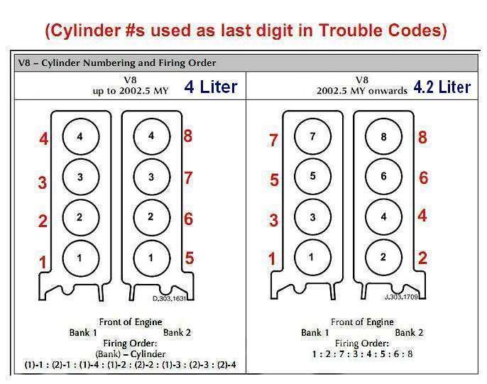

Wrong coil.
This pic has been displayed on this forum for years.
See the actual coil/cylinder layout for the 4.0

Another example of confusing Jag docs: on the X308s, 303 is third back on right side -- as Bob noted. I guess the confusion rests with the fact that in the UK, 2003 models are 350s.

X350 in uk started at 2003.5. In usa 2004.
