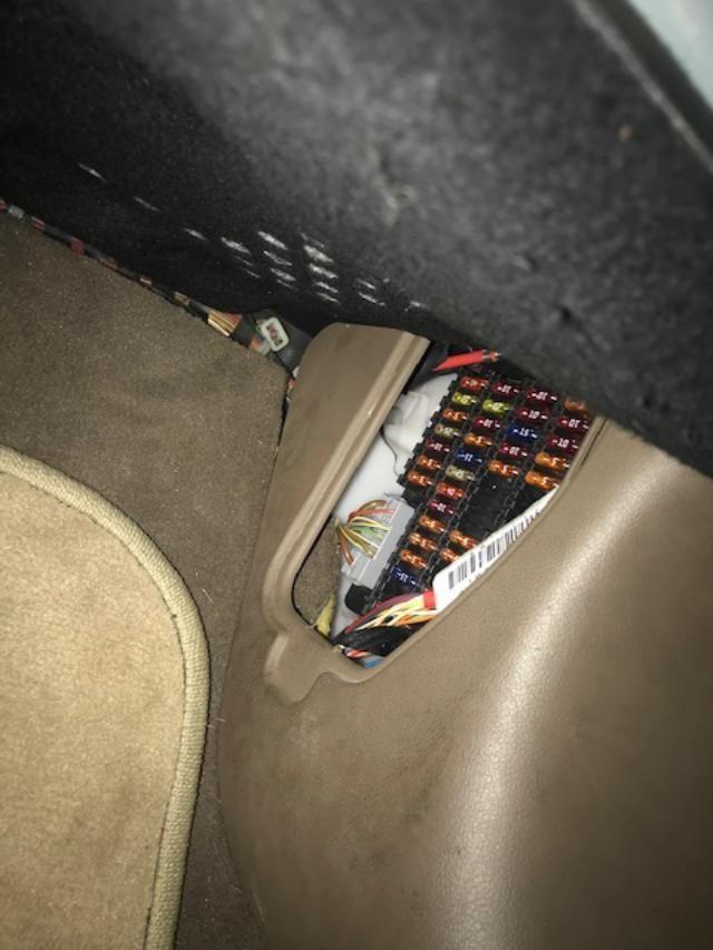

Radiance was down the entire holiday season with a dead battery and trunk locked. The mechanical key turned but apparently requires current to operate the mechanism.(battery dead..???). There is nowhere under the hood to locate a positive lead to safely get 12v to open the trunk and charge the battery.
Here's the fix: About 6 to 8- inches in front of the door speaker in the right-hand side footwell is a small cover- the same color as the kick panel. Pop it open and there is your positive cable with a lug to attach to. Apply power and open the trunk. Then charge the battery... Brits design beautiful cars! but...

You may want to post this in the X350/X358 section of the forum, this is the X308 section and that electrical fuse location does not apply.
