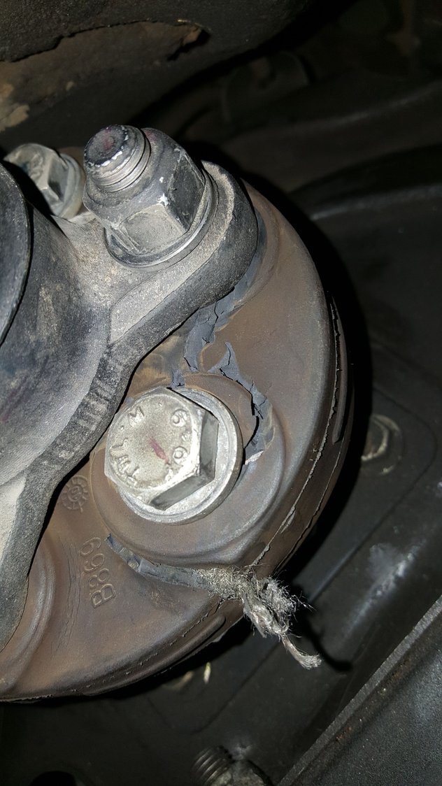

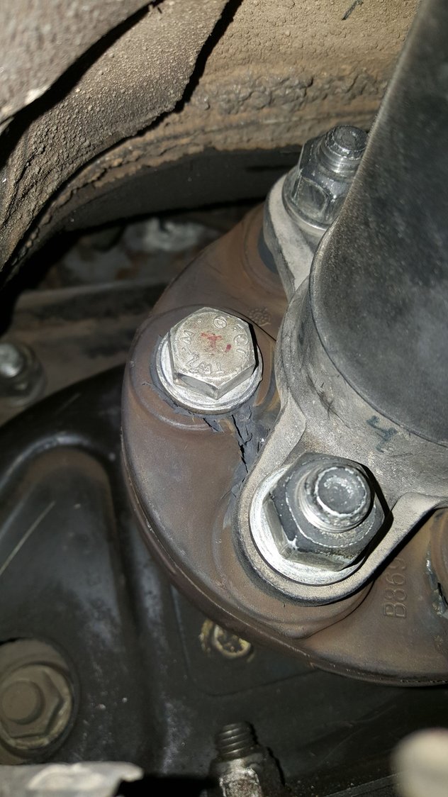

Driveshaft buckles under moderate acceleration, causing the Y-flange of the u-joint to make contact with the undercarriage, making a knocking sound. The differential unit, 2 jurid couplings, and center bearing where all replaced around 8 months ago, yet the rear jurid coupling is shot.
It seems like there is a lot of resistance between the transmission and the wheels, yet when I rotated the wheels by hand and rotated the driveshaft by hand, I didn't notice anything unusual, except that my right rear tire is more worn out than the left rear tire.
Could it be that the condition of the jurid coupling is causing the driveshaft to buckle under moderate acceleration?
Differential-end jurid coupling after 8 months of use
Areas of the Y flange of the u-joint that make contact with the undercarriage when driveshaft buckles under moderate acceleration.

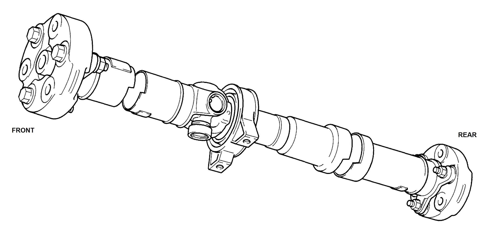

You certainly need to replace the damaged coupling. Take care to install it in the correct rotational orientation, as shown on the pics below (note the arrows on the coupling and the thicker and thinner segments).

It seemed as if the old coupler was mounted correctly. Anyways, I swapped in the new one, making sure I marked all the bolts and lined up the shaft to the differential input shaft correctly. All is good now, and I can burn some rubber now. The problem was that the cracks in the coupler compromised the rigidity and allowed the driveshaft to flex and buckle.
I had check this same coupler a couple of weeks ago and didn't see anything out of the ordinary. I guess on one hard acceleration, it just decided to give out.
