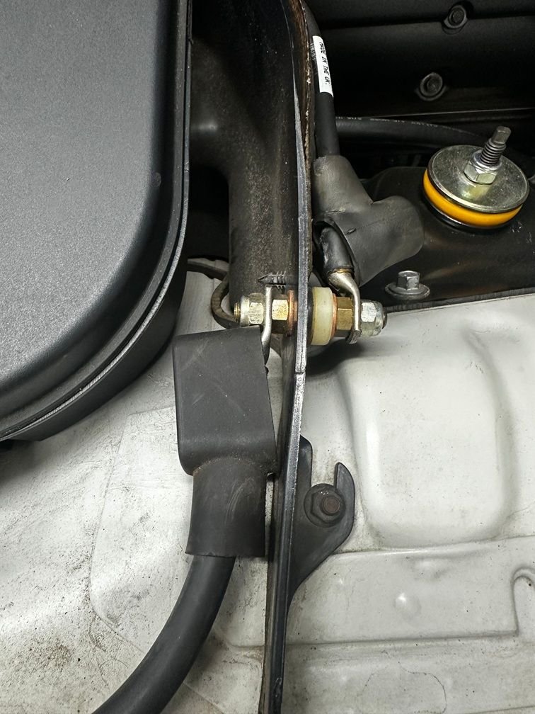

Also check the 'power-stud' connection at the false bulkhead in the engine compartment!

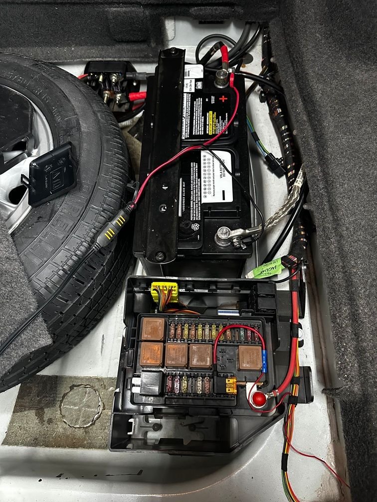

Jaguars have a lot of electrical connections in the battery power circuit between the battery in the boot and the alternator and starter in the engine bay, and corrosion on some or all of these connections causes cumulative resistance that can cause lots of difficult-to-diagnose electrical gremlins. Cleaning all of these connections is something I've learned to do every few years, or if I'm working on something else near any battery power or ground connection, I'll take a few minutes to disassemble and clean that connection. This can help prevent no start, slow cranking, and other faults such as the notorious Gearbox Fault warnings.
After you clean the false bulkhead post Bob (motorcarman) mentioned, I would recommend removing the engine ground strap and cleaning the terminals, bolts, nuts, washers and mounting points with a small brass-bristle brush and zero-residue electronic contact cleaner (I use the CRC brand).
Next, remove the spare tire and the black plastic cover of the High Power Protection Module, which is mounted low on the bulkhead just right of the vehicle center. Take photos of all the connections so you can reassemble the components correctly. Remove the nuts, detach the cables and remove the megafuses. Clean all the eyelet terminals, threaded studs, washers, nuts and megafuse blades with your brush and contact cleaner, allow to dry, then reassemble.
There are plenty of other connections worth cleaning. You can find all the battery power and ground locations in the Electrical Guide, which you can download at the link below, thanks to Bob, who provided the file, and Gus, who hosts the website:

Didn't seem to be any parasitic drain. When car came back to life on its own, it started up no problem. Only thing I've had time to do so far is visually inspect the already mentioned terminals and nothing is obviously wrong.
Boot Terminals False Bulkhead
Thanks for all the pointers. Will go through the rest of the list of checks probably on Sunday.
