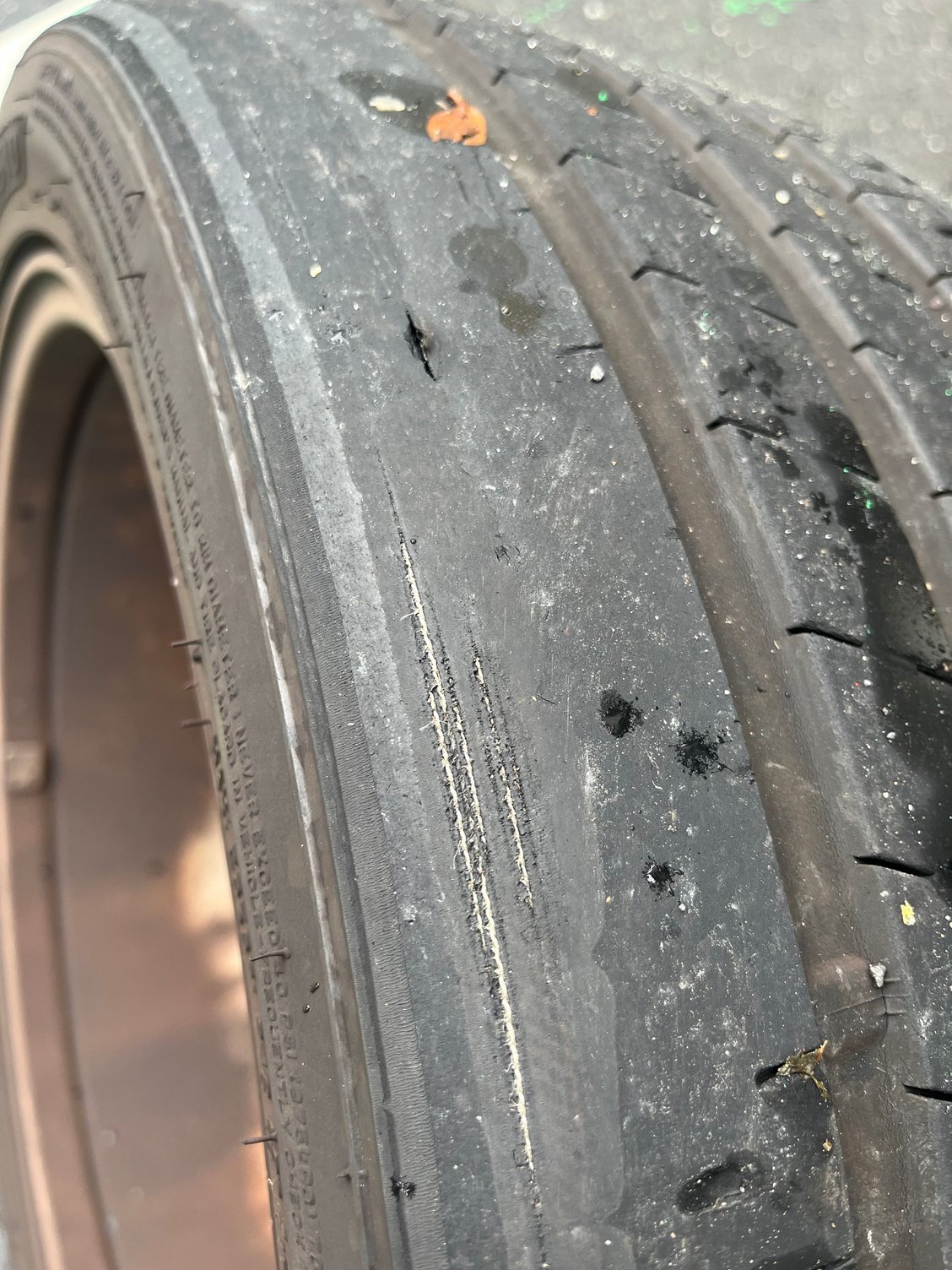

My 2000 xjr is my daily driver with 155,000 km.
I got new tires in mi 2022 and have probably driven 15,000 km on them.
Today I had them rotated today. The front tires were especially worn out on the inside. The back tires were fairly evenly worn.
is the alignment off perhaps?

Bushes, have a good pry with a bar and see which is loose. Probably upper wishbones.

Yes, if it is not he bushes, you definitely require a professional wheel alignment.
Lift the front tyres up with a proper car jack (best not to use the one is the boot, as that one can be quite dangerous) - lifting one front wheel after another is good enough - and then try to move your (lifted off the ground) wheel by trying to push and pull it with your hands. If it moves, you need new bearings.

Toe out can wear the inside also.

Yes, sure. "Toe out" is one of the possible incorrect kinds of wheel alignment.
Which is why I was (above) already leaning towards a wheel alignment.

A professional wheel alignment is something I should only do at a Jag dealer? Or is a well regarded service shop ok?

A good tire shop should have laser alignment like sharkeye, I would not suggest the Dealer as they add their cut, after sending it to the tire shop in a few cases I know of.
It's bushes though.

As Sean says: Go to a reputable tyre shop with laser-equipment and a guy, who is able to operate it correctly.
But only after you are sure that it is not he bushes, because if you go with worn bushed to the wheel alignment, the wheel-alignment was "for the cat"...

How do I check the bushes? Is this a big job?
I assume the XJR needs some work done on the legs as I'm hearing clonking sounds from the back.

however, before you do...make certain to get an alignment...and/or
replace whatever is causing such uneven tire wear.
