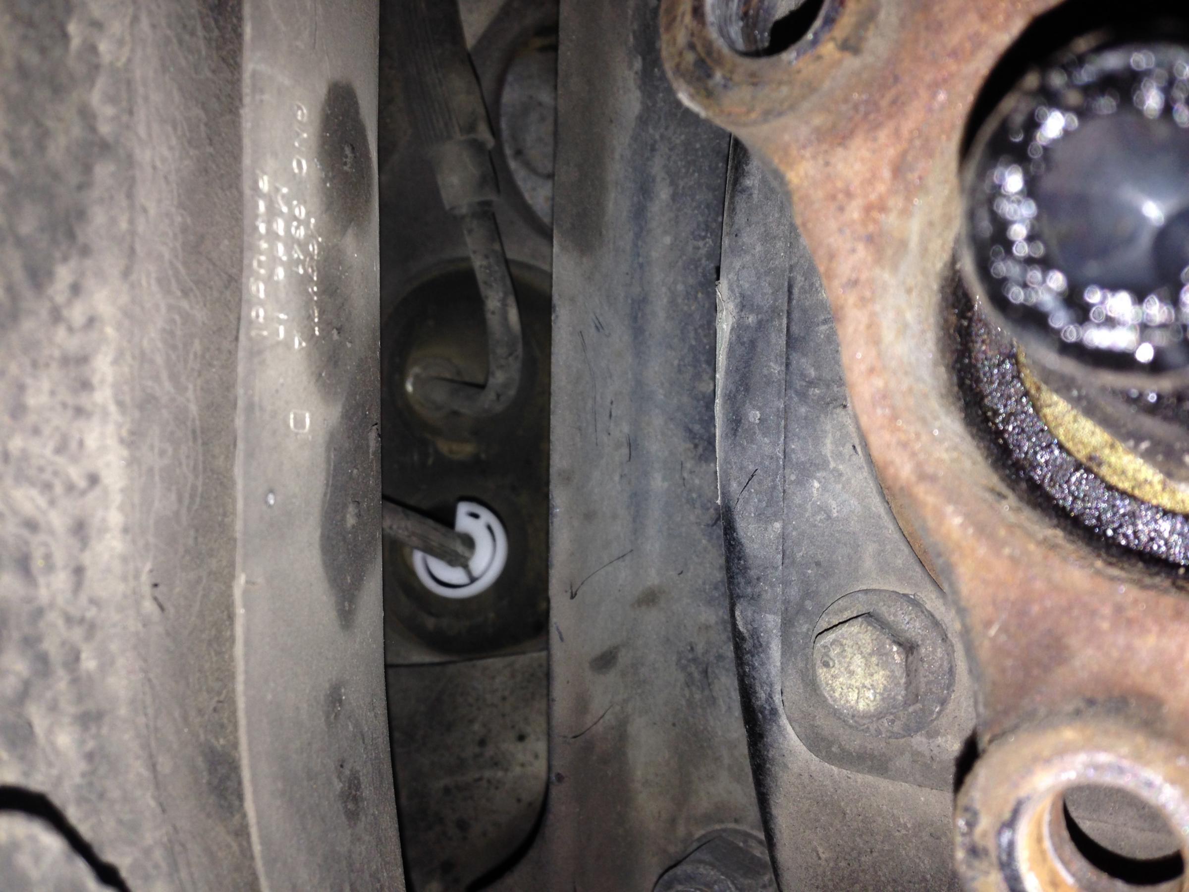

Does anybody have experience with the fuel lines on the X308? My fuel supply line between tank and filter (NNA6082AH) has sprang a leak. Is it possible to replace it without dropping the rear suspension cradle?
Have to admit, it does not look like a fun job. Perfect recipe for a face full of gasoline, ugh..

You don't have to drop the cradle, there are ways around it. Check out the fuel pump link in my signature, it may help you out. I haven't changed that line, but I would think it can be done with a bit of swearing and fiddling around.
This picture is mostly here so I can test uploading a picture direct to the thread, but you can see the access to the tank disconnects.
