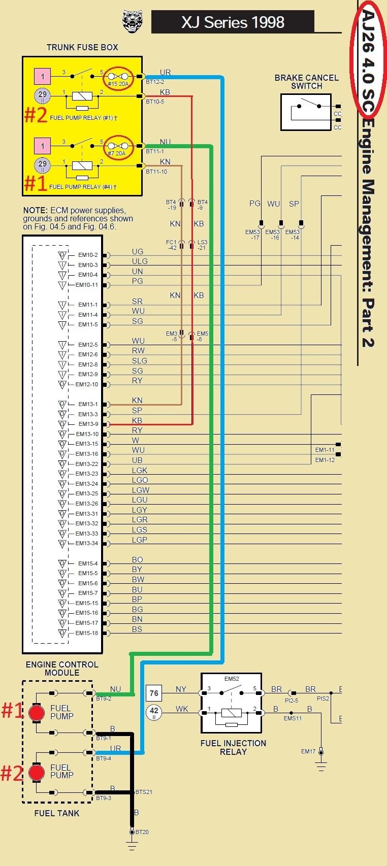

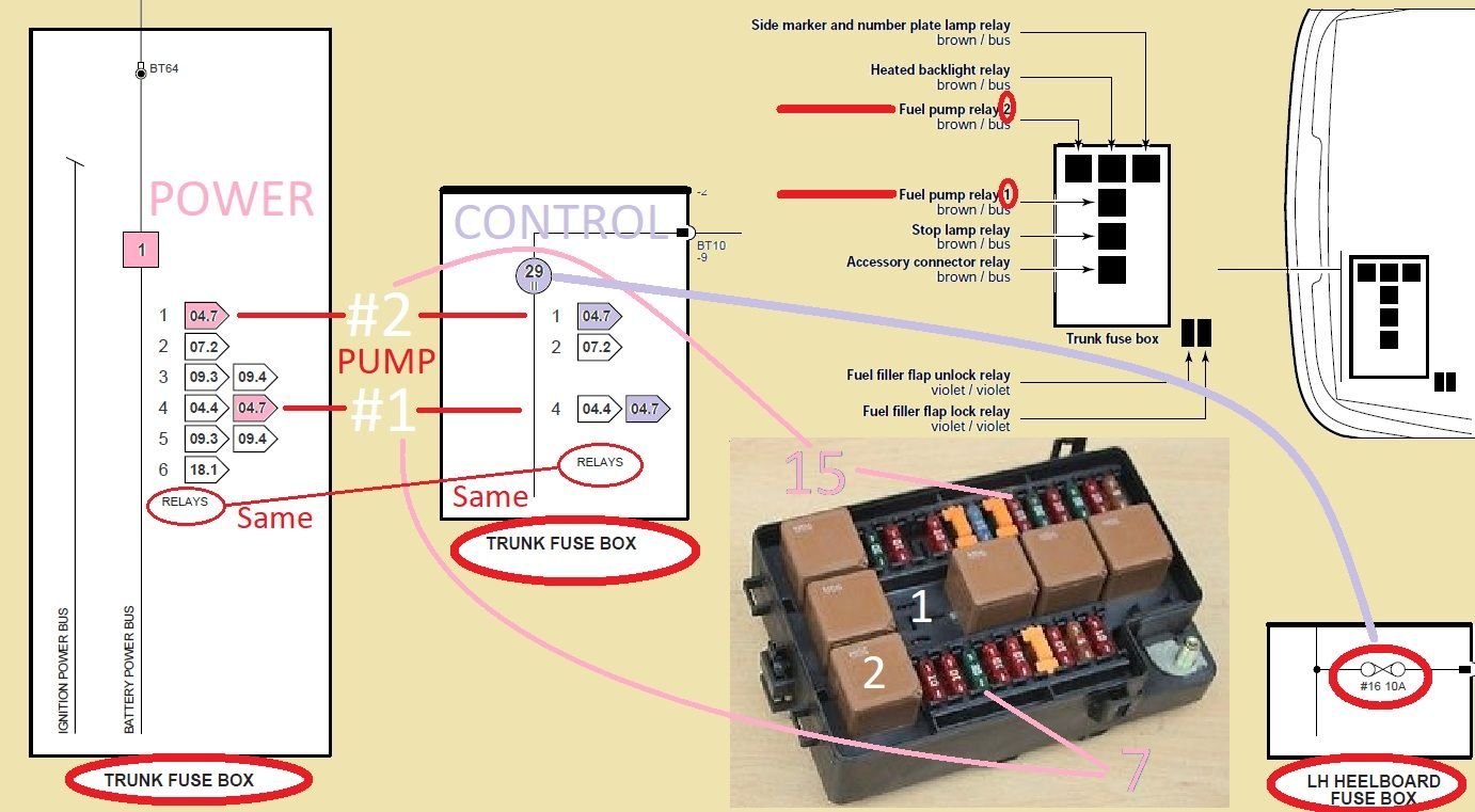

Notice how the fuse is after the relay
Notice the secret fuse in the left heelboard fuse box # 10
This fuse may have to have the ignition positive # 2 close to power the fuse
This relay can be seen on page 39 and 41 as the 2 circle double hash electrical point
jagrepair.com/images/AutoRepairPhotos/jagxj2001.pdf
Your fuel pump control is Y electrical point
