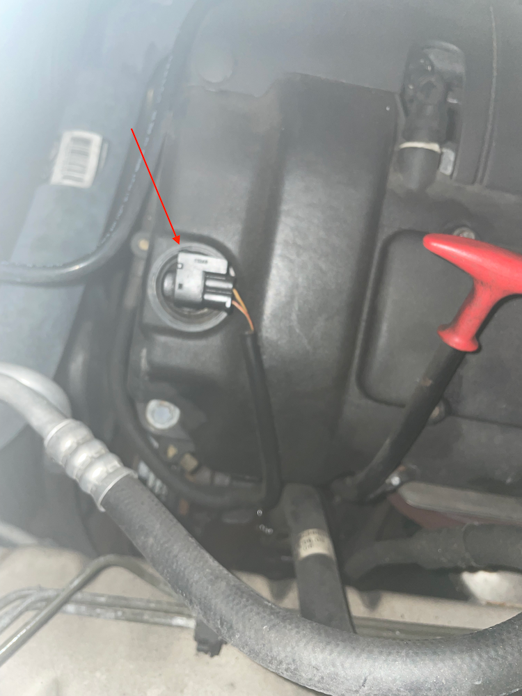

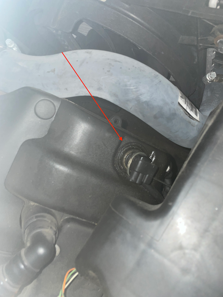

I need to replace valve cover gaskets (left and right) on my 2003 x308. However, I also noticed that it's leaking at two plugs, I'm looking for help identifying it.
Thank you for your help.

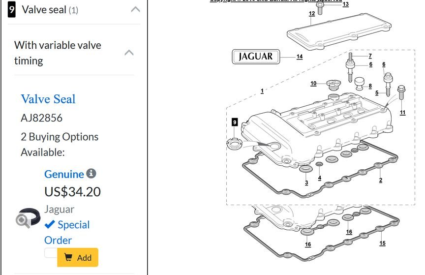

Those are the seals for the Continuously Variable Valve Timing (CVVT) solenoids. (Item # 9 in the diagram above)
Jaguar part # AJ82856.
(Also note there are two styles of valve cover gaskets, early and later types, yours being a 2003 has the later type set).

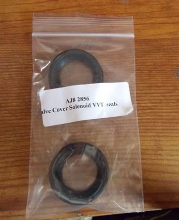

@Carnival Kid thank you. I also
ordered two solenoid seals you linked for me. Thanks!
