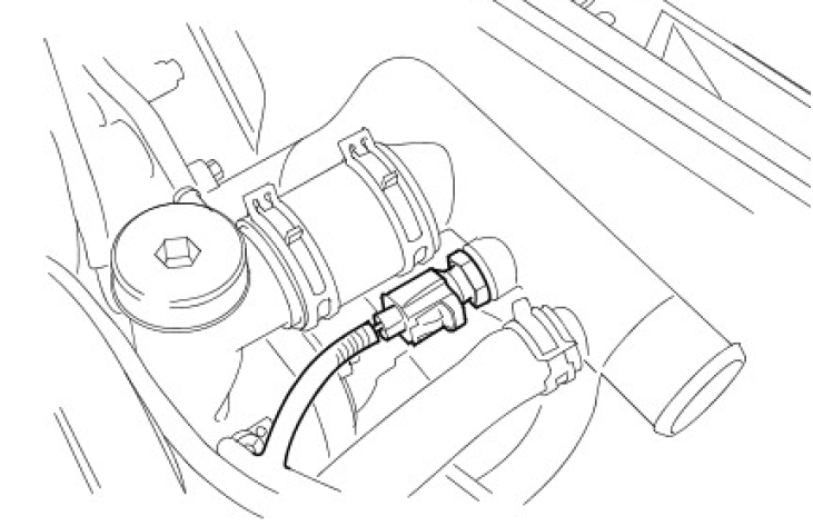

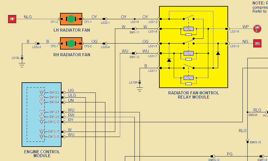

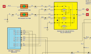

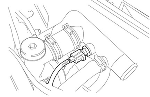

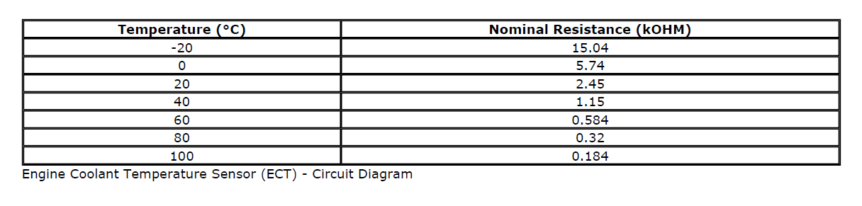

The following pertains to the fan operation for the 1998 / X308 :
The ECT sensor is a thermistor vs. the old school variable Temp. sensitive resistor so it responds to Temp in the opposite direction of experience , as the resistance goes up outside of the sensor it believes it is seeing colder Temps. as it signals the ECU .
Check for a secure and clean connection in the pic below .
Fuses :# 67 on print = #12 - 30 amp Engine Compartment Fuse Box
..........# 63E...........= #14 - 10 amp Engine Management Fuse Box
..........# 68.............= #14 - 30 amp Engine Compartment Fuse Box
To see the fans run just remove connector and short with a paper clip , low current so no concern .
Or you can remove the sensor and heat with a heat gun to see them run .
The IAT sensor will read the same resistance value before you run the engine and warm up the coolant .
See the thread below :
https://www.jaguarforums.com/forum/x...-sensor-70566/
