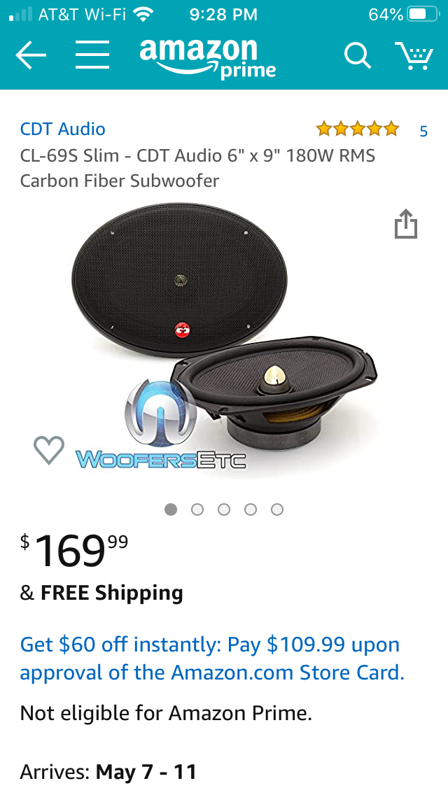

I found these, maybe they’ll work???

I think those were the ones I saw back then. If the mounting depth isn't too deep they would probably work well. Sensitivity and impedance will affect how well they blend with the factory amp, as in how "loud" or efficient they are vs the oem sub.
