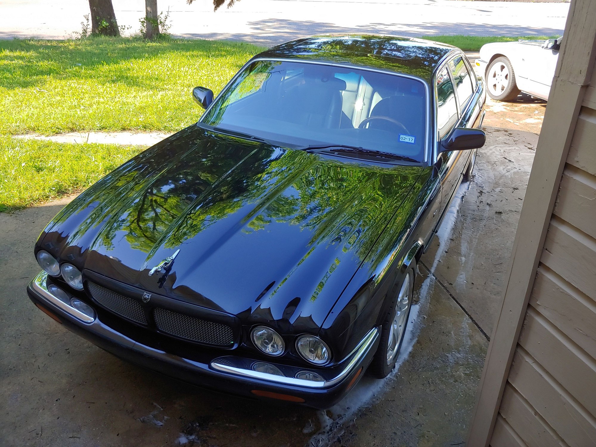

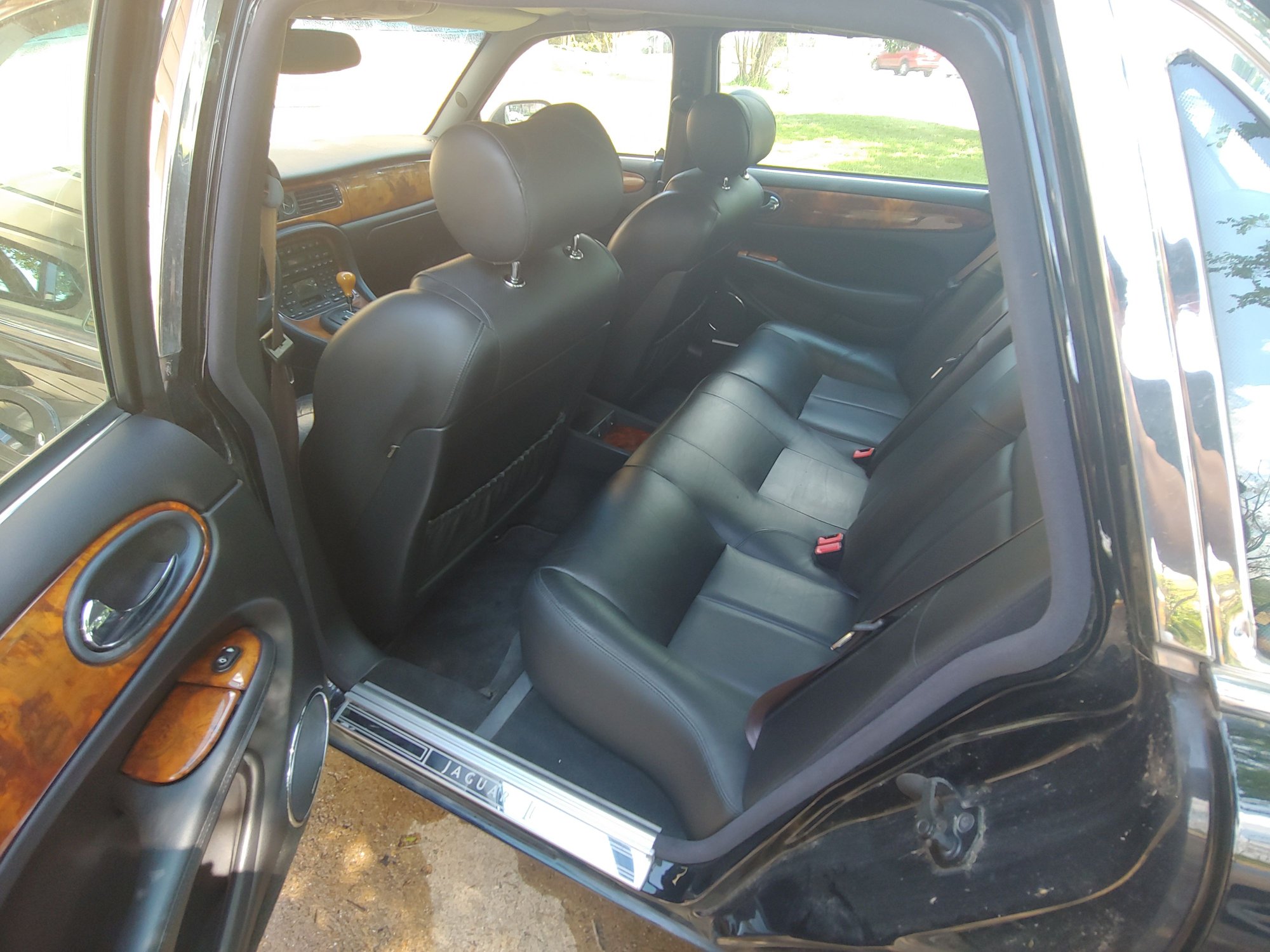

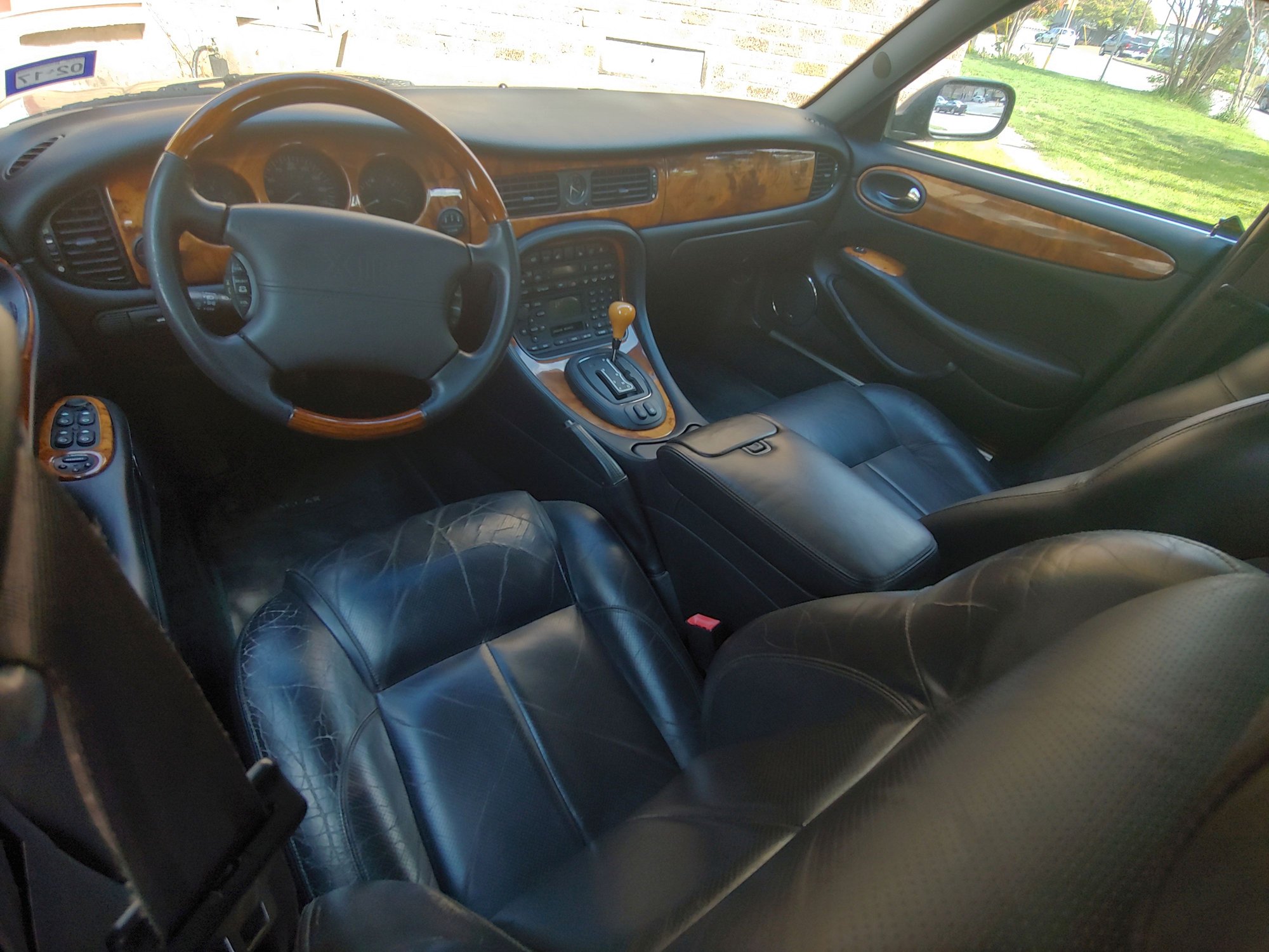

Thanks for the info guys! If I do pull the heads, I'll end up keeping the car. And yes, I will drive it spirited. Pics of the car that I believe I haven't posted.

Wow, now I can see why you didn't want to give up on her. Black on black is sexy and you've given her a nice cosmetic gloss shine...good work. The interior looks very good to great also, ...though I was with ya until ya said LS swap.

Seeing those pics, that car needs to be saved!
