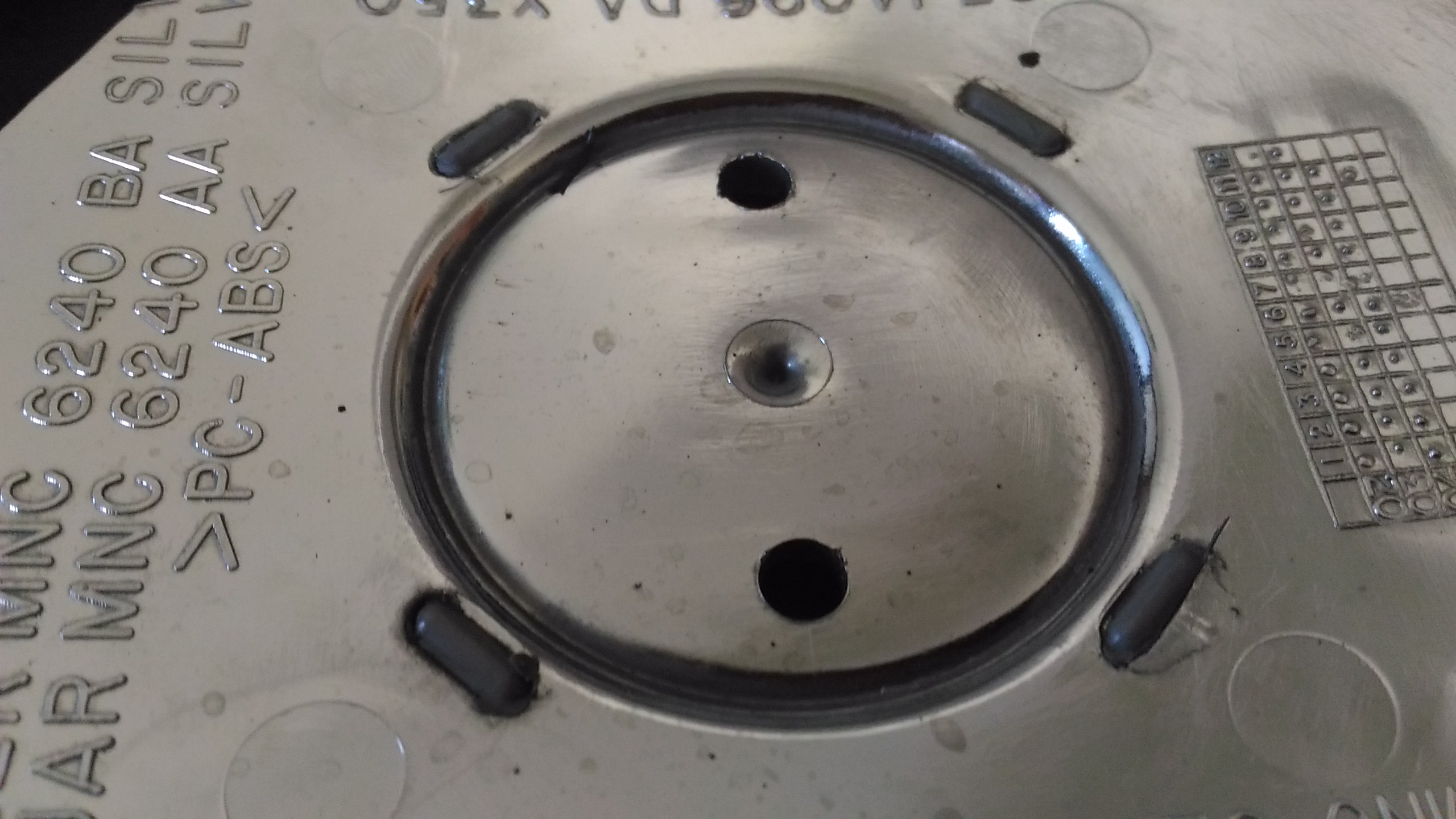

Originally Posted by DimitrisBXL
Now I have to find how to replace the insignia badge. :-p
Bcrary3 was kind enough to send me 2 pcs as well.
for the badge, you will have to push it out from the inside first.
Use something sturdy which fits through one of the holes, and push.
Pre-heating with a hair blower helps a lot to make the glue soft.
If you have just the Daimler badge, it is a straight re-install.
Use thin, dark 3M tape and cut around the badge, then fit on the cover.
If you got a Daimler center cap, you will need to take it carefully apart, I am not sure you will be able to do so without damaging the part you need.

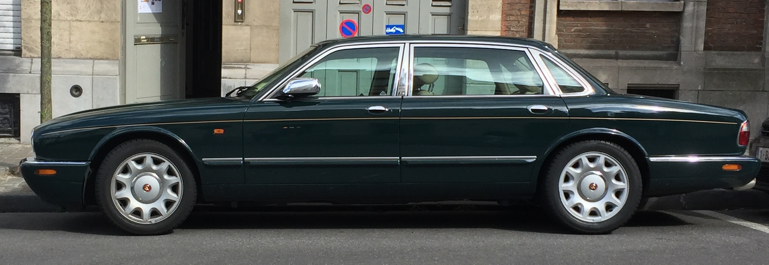

Thank you Eric,
I did the change of the centre caps earlier successfully. I didn't have a 3M tape so I used super glue. I will post some pics when I install the hubcaps on the wheels.I read the thread you quoted yesterday :-) , but I am not very DIY skilled. :-)
Edit: the pics with the new hubcap and centre badges.

Showroom new and clean ...

I love the pinstripe going down the body... Was that from factory? I may do something like that after mine is painted, just don't know what color to pair with red. Silver maybe?

Yes, its factory done, Your Van den Plas should have one too. As I know the pinstripe was a standard feature for all top specced cars. Red and gold is a classic. ;-)

Generally, and surely with exceptions, US spec cars did not have the coach-line or pinstripe.

Looks great
