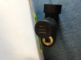

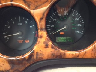

OK I checked the resistance of the left wheel speed sensor and it was at 1160 ohms, I moved the sensors wire harness around and no change in the reading I also examined the wires and found no breakage. I also checked the rest of the wheel speed sensors and they all measured the same resistance. I dont know what else to do I still have a check engine light on , ABS, and a stability control fail. Also BTW the check the cruise control is not working as well I dont know if that is connected to these problems. I uploaded a pic of the sensor I replaced It looks in decent condition , also I cleaned the rest of them they all seemed pretty clean compared to other ones I have seen online.
Attached Thumbnails Need help on C1175 code!!-cruise-control.jpg   Need help on C1175 code!!-wheel-speed-sensor.jpg   Need help on C1175 code!!-jag-dash.jpg

I just 'scrapped' a JLM20555 ABS module on a 1999 XJ8 customer car because C1145 would NOT clear. I substituted a 'known-good' module and the DTC did NOT occur.
I plugged the module into MY personal 1999 XL8L and the DTC was present and would NOT clear. My 1999 sedan does not have any issues with speed sensors or link harnesses.
I tossed the ABS module into the scrap heap. Sometimes the modules themselves are the problem, not the vehicle.

Eddie,
Bob's and RJ's experiences notwithstanding, before you scrap your ABS module it would be worth having a look inside for cold, starved or cracked solder joints. I recently opened a module that had been "refurbished" by a well-known firm, and discovered they had only reflowed the solder on the two large pins for the pump power connector. Yet there were several other solder joints that were obviously not in good condition, including some on the pins for the main connector through which all the wheel speed sensor signals pass. It would at least be worth a try to reflow the solder on every suspect joint on the circuit board of your module just to rule out a bad joint as the cause of your problem.
At the link below Gus shows how to remove the ABS module:
Jaguar X100 X308 ABS Module Removal
And this link shows the module circuit board on the last couple of pages:
ABS Module Repair
