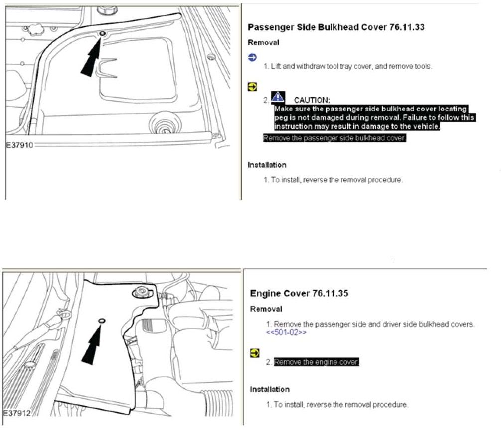

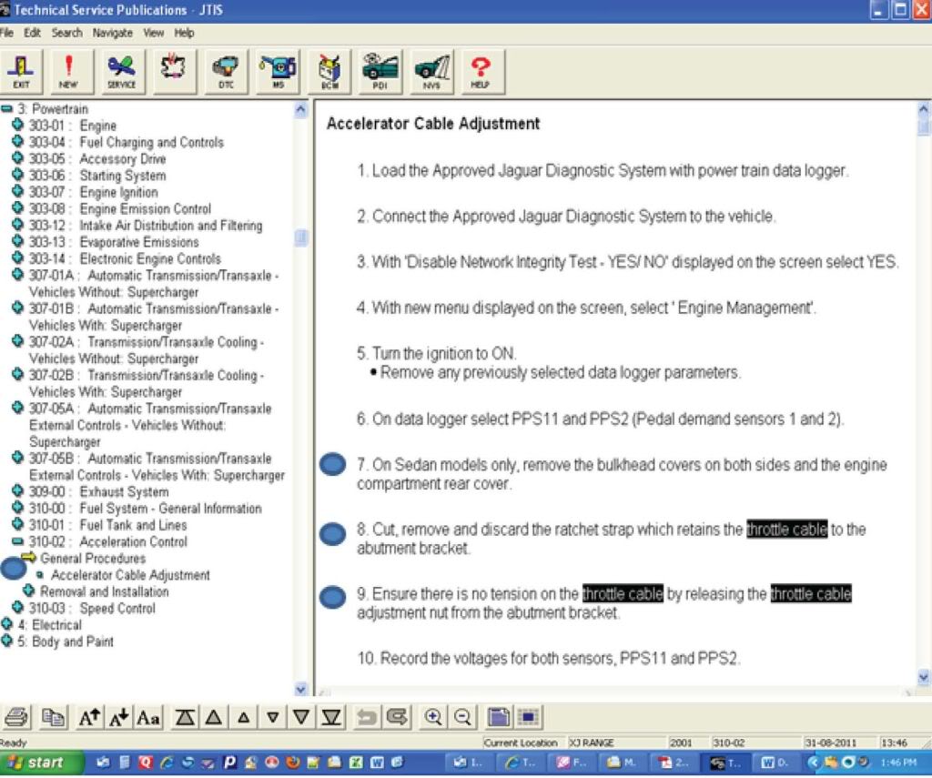

Here are a few JPEG files I created from JTIS21 - I put a Blue Dot on some of the instructions to indicate the only steps probably needed. You can view a larger image of these JPEG files by click on the yellow bar above each of them that has message "This image has been resized. Click this bar to view the full image."
Note the instructions say "Remove both Bulkhead covers on both sides", I found that I only needed to remove the Driver side Bulkhead cover and then the engine rear cover slides out without removing the Passenger side Bulkhead.
The last image is a photo I took of our 2001 XJ8 Engine Compartment showing the Throttle Body and the Throttle cable that might need adjusting.
