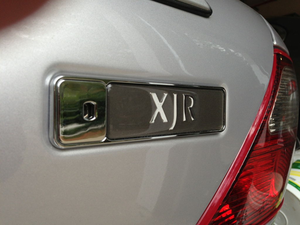

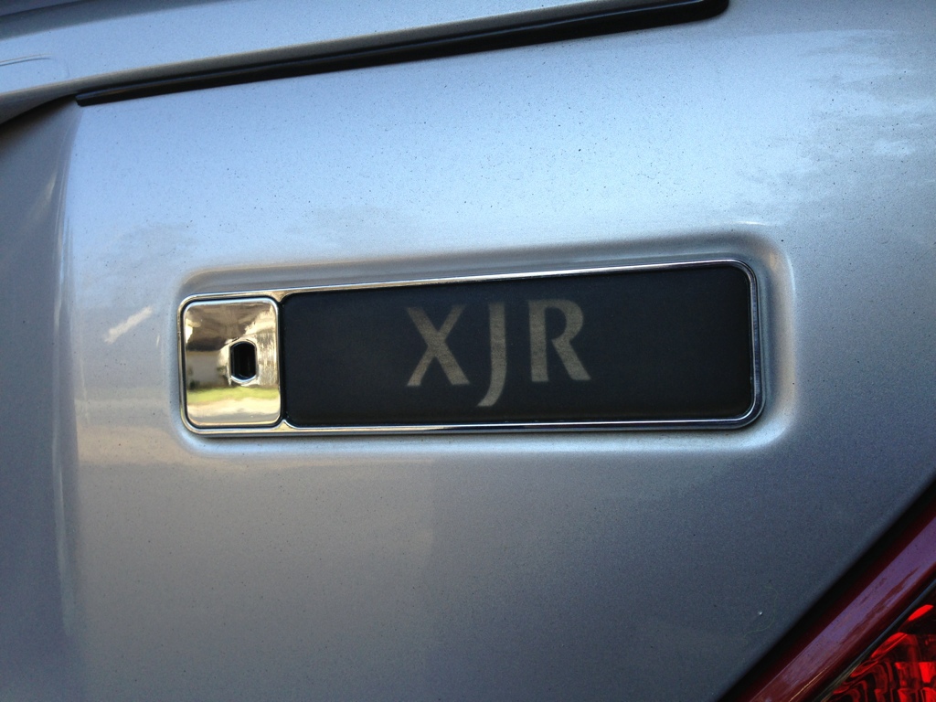

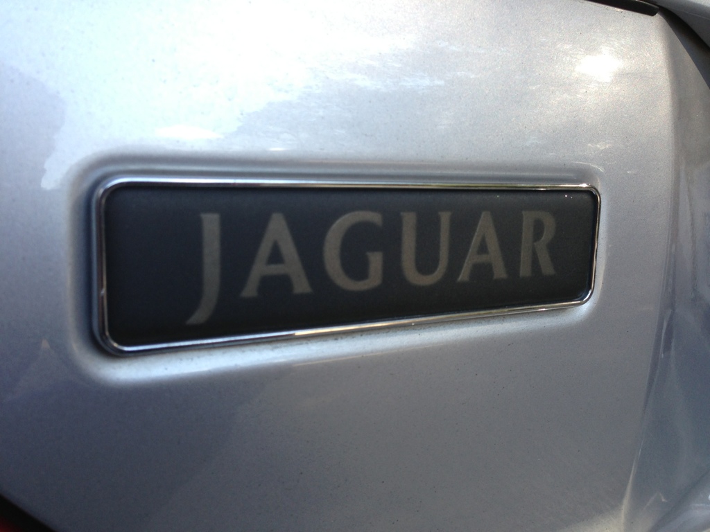

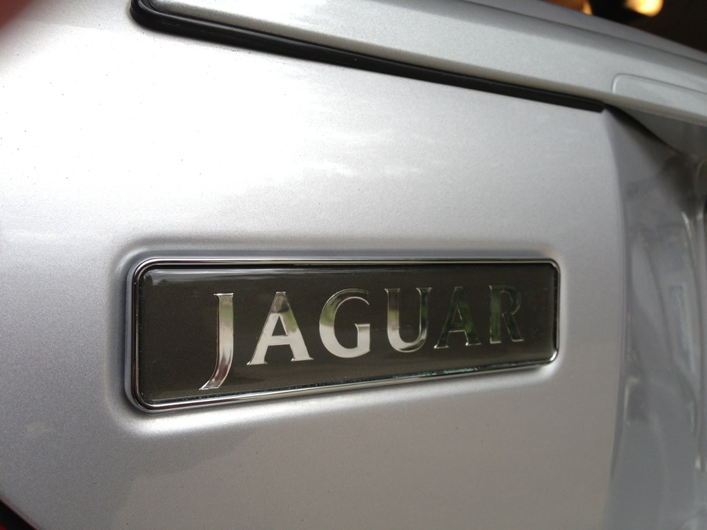

Found new rear badges for my XJR on ebay. They arrived quickly and I fitted them. my process was basically to pry them off a bit and then pull fishing line back and forth behind them until the badge was separated. after some glue remover the new ones stuck right on.
Old Jaguar badge:
Old XJR Badge:
Surfaces prepared:
New Jaguar Badge:
New XJR Badge:
