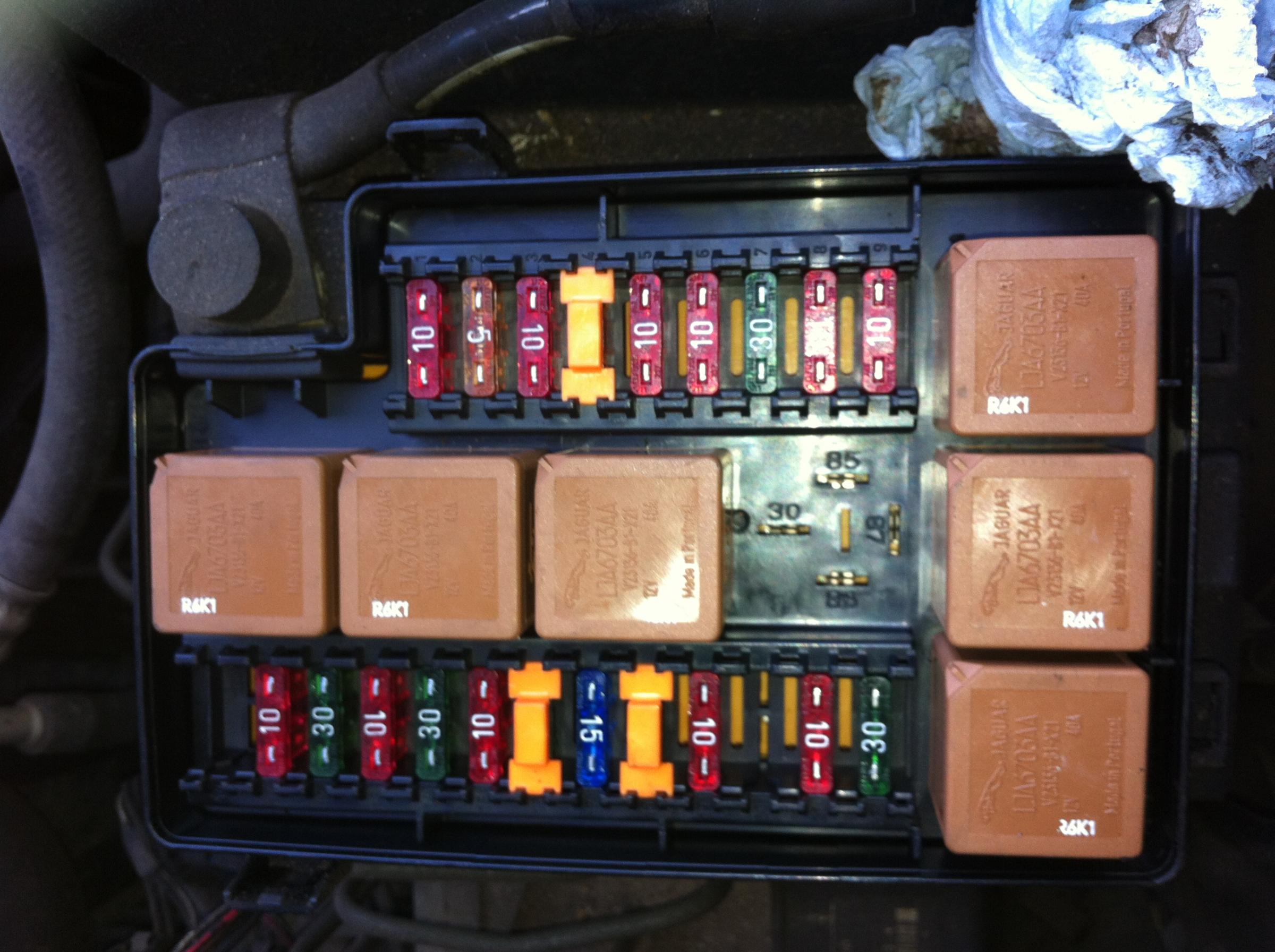

hi there, i hope so can help me, my scanner wont read my 98 x308 i have checked both fuses (1 in the boot and one behind the heal board) still with no luck, i get as far as it starts to read the code and then my scanner switches off and goes back to the start. also while i was at the the fuse board in the boot and 1 in engine bay, it looks like there is relays missing, can shead some light if there is ment to be anything in these slots? looks like 2 in the boot fuse board and 1 in the engine bay? hopefully there is pics included.
cheers dave
