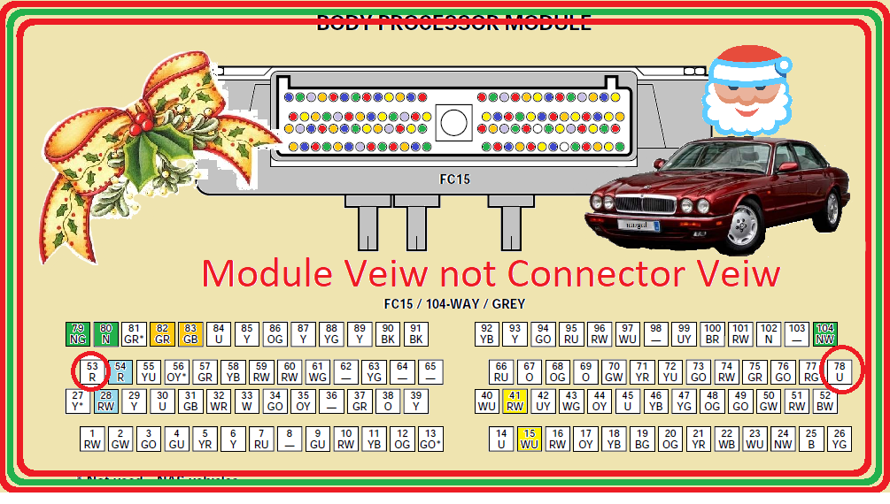

There is a common wiring problem of the grounds inside the 2 main lower lamp assemblies on the X308 or the 2 seater X100 I can't recall which
Ask questions

LP w/ the holiday themed schematics, upping the bar I see lol.
Old Dec 21, 2018 | 09:08 PM
Lady Penelope's Avatar
Joined: Apr 2017
Posts: 4,039
Likes: 1,397
From: Kansas City USA
I'm just working with what I got , and that's not alot
