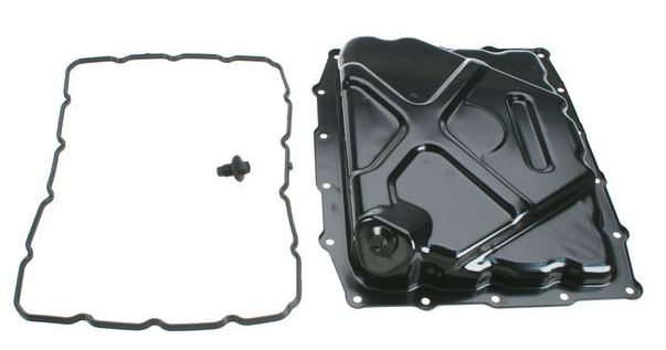

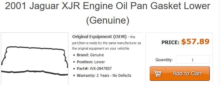

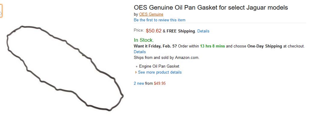

jeez, just doing some looking around...i found a few and they all look different.
i attached pictures of the ones that say it will "fit" a 2001 XJR.
the first one looks promising huh? (the one with the pan)

The oil pan gaskets shown above are all the same. They are just laid down in different "poses".
