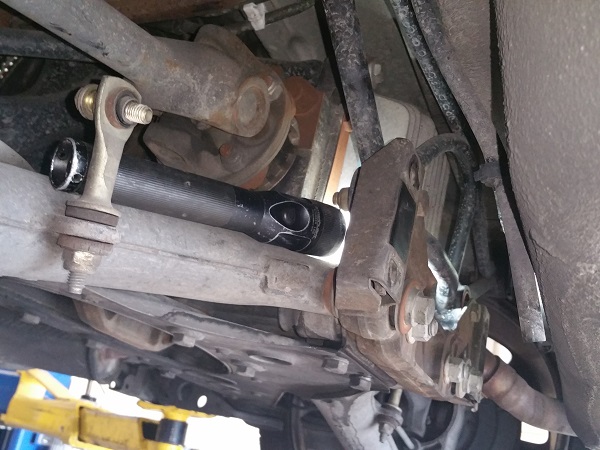

2) is this the fill plug?

There are multiple threads in the past on changing the
diff lube.
You will find that it is not necessary to remove the swaybar.
Some use a wobble extension, some use a drive adapter + box end
to reach the fill plug.
The breather unscrews using a box wrench.

Changing diff oil is a simple job ;o)
Clean the plug area and I use either a 1/2" ratchet with no socket or have a special cut down long 1/2" section bar that was heated and bent at 90 deg.
and cut so that it was just long enough to enter the filler plug.
the long section is about 10" in your money ;o)
