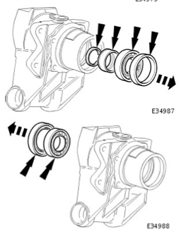

Hi All-
Those of you that may know me and were following my last 'no start' thread. Know that I've been shipwrecked for the last couple weeks with an asthmatic jag. Its now back running and has a new problem. NEAT -_- 01 XJ8 112kmi
Symptoms: Rear wheel noise. A steady grinding, with an abrasive wash, that increases in volume with speed and matches the cabin air noise around 65mph.
Circumstances: The car was running perfectly before its no start incident and was laid up for two weeks, just sitting. Surrounding temperatures range from cold to very cold, here in NY. (Single digits to negative)
What I've done so far: Lifted the car for a visual inspection and quick tire shake. (cause not found err404) Removed rear brakes to inspect caliper health and pad health. I found no defects, and replaced the rear pads. (cause not found err404)
In the other posts I've read I have found the same symptom with a range of causes varying from; wheel bearings, differential bearings, to the driveshaft center bearing.
Current logic line: Ferris Bueler. Lift the car, free wheel the drive line, use a stethoscope to inspect each bearing for integrity. *Do not push out window*
Thoughts or recommendations?
Thank you all,
-Mitch
Attached Thumbnails Out of the frying pan and into a frying pan-center-bearing.png   Out of the frying pan and into a frying pan-rear-wheel-bearing.png

Mitch,
That's a good next step. With the rear end supported on jack stands and the front wheels securely chocked on both their front and rear sides, you can check all the bearings - just take care not to touch any rotating parts with your stethoscope probe, and do as much of your probing as possible while lying beside the car - spend as little time as possible under the car.
Be safe and let us know what you find.

So tonight I put the car in the air and had zero wiggle room on the rear tires. No play whatsoever. I took off my tires, calipers and rotors to remove as many possibilities for mistaking the noise.
I couldn't replicate it. Both wheel bearings (both sides) sounded the same and both sides of the pumpkin sounded identical. The center bearing made almost no noise at all.
Right now I think that over the two weeks it was laid up, one of the bearings developed some condensation and some rust, within the bad bearing itself. Now that I'm driving it daily it's started to remove that coating and go back to not being so noisy.
Recommendations? The diff being dry has not left my mind either.

A few thoughts come to mind. One is that, with the rotors and wheels removed, there is very little load on the bearings, especially the outer ones, so you may not have gotten a true sense of their condition.
You mention that both of the diff output shaft bearings sounded the same... were they fairly quiet with no grinding sounds?
What prompted you to think the diff could be dry? Did you see any signs of oil leaks at the pinion, either output shaft, or the rear cover?
Your theory about the one or more of the bearings rusting while the car sat for a couple weeks could be valid, but would imply that those bearings are both short of grease and subject to water ingress, so if you're right, you'll need to remedy the situation as soon as you can figure out where the noise is coming from.
Please keep us informed!

Thanks for sticking around. I thought the same thing about having the wheels on or off for the test. I didn't quite have the time to run both as odd as that sounds. I thought that regardless of load the culprit would be fairly easy to spot. No so much.
Both of the diff output shaft bearings seemed to have normal noise. Fairly quiet with a definite sense of movement within. No real grinding, just the noise of rotation. To put my findings into a different perspective. All of the bearings had an almost identical sound during the test.
Onto the possibility of a dry diff. The only line of reasoning I have for that is that I don't that much about the history of the car. My instincts tell me to shy away from that largely because: 1) This popped up after sitting for two weeks. 2) I've had no leaks at all and the diff looks dry. 3) This is a new noise and I think if it were going dry I would've heard it prior to this incident.
Some new news: It seems to be temperature related. Driving it this morning it was much different than driving it home last night. The temp yesterday was about 23. The temp this morning was only about 5. It was noticeably louder this morning. I'm sure that Jim Hartz will nod when he reads that .
Looking at the manual and some online photo's. The bearings in the diff look pretty beefy. I would be very surprised if I changed wheel bearings on both sides and either didn't identify the problem right away when I took the bearing apart or the noise was still there after reassembly and test drive. I hate to throw part$ at a problem.
Thoughts?
