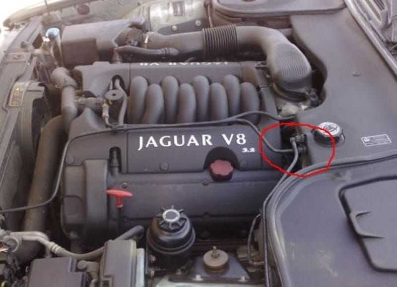

Follow #10 to conclusion: you have a leak if you smell coolant. Sometimes they dry up quick, making discovery tough.
But once in a while (actually more often), the hoses from the tank are misrouted.
They must be as shown, otherwise coolant blows out.

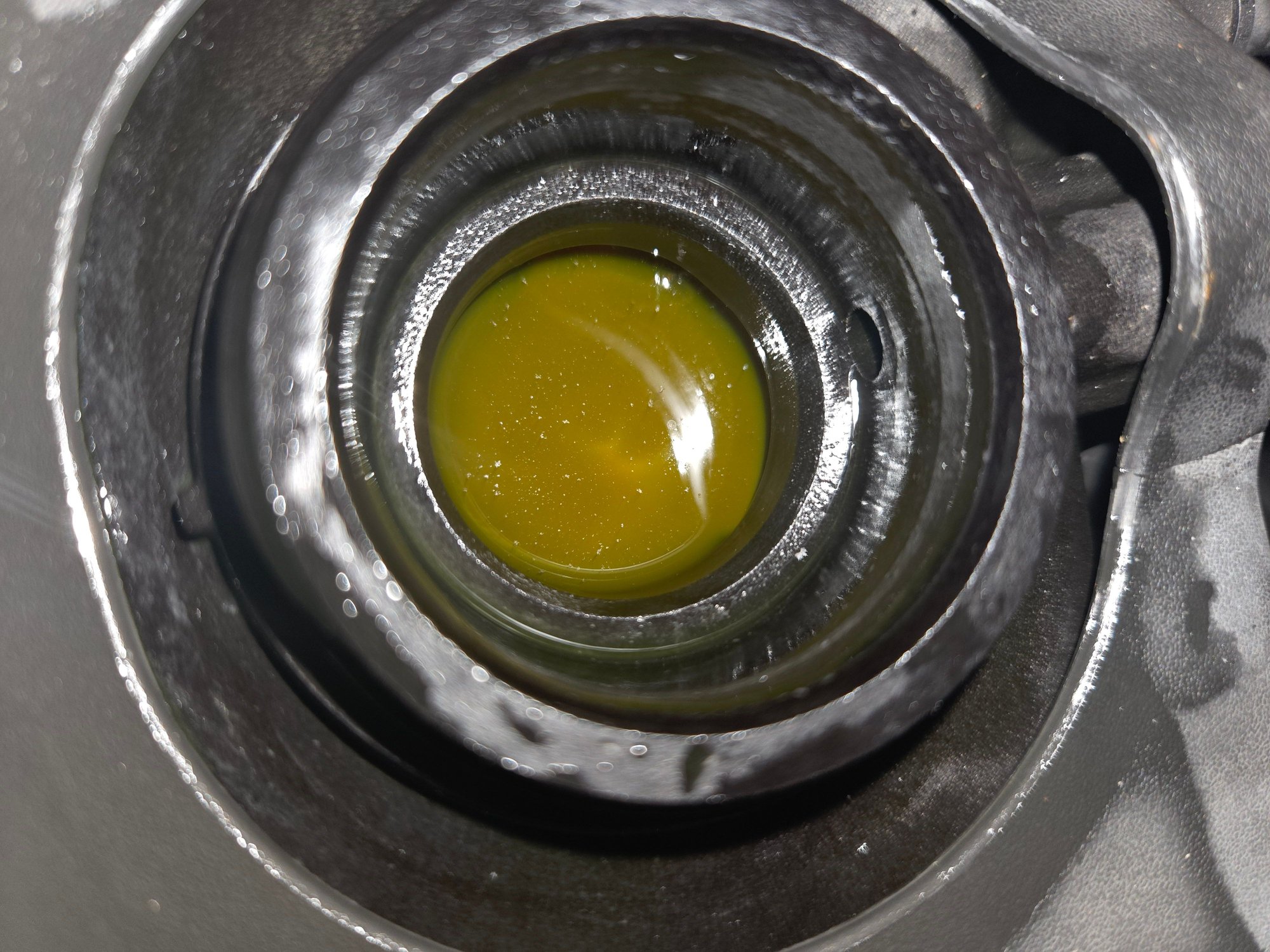

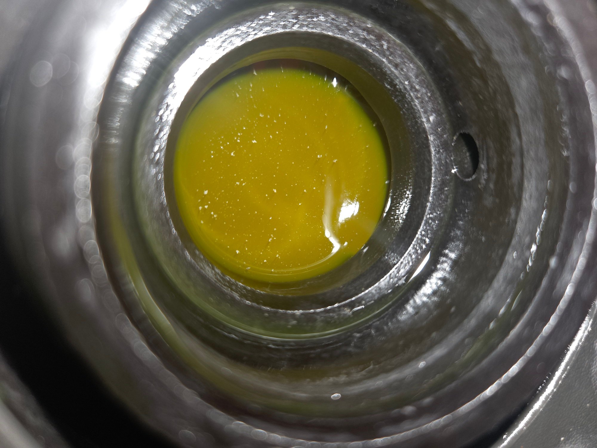

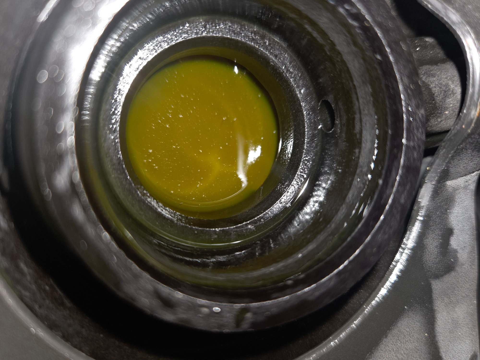

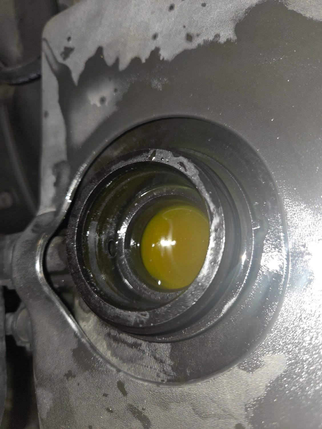

So far I haven't seen any changes, the tank has been pretty much at the same level so far, when I went for a drive in the morning and let it sit for 3 1/2 hours some pressure was still in the system so it was up to the neck of tank and come out a little out of the top when I took the cap off. but after rechecking it at night it was a little before the neck of the bottle where it was i did squeeze the hoses in the front of the engine to make sure the level didn't drop but it looks ok as of now. dont mind the spill that's from when I initially opened the cap when there was pressure but this is the level its been at the past few days.
