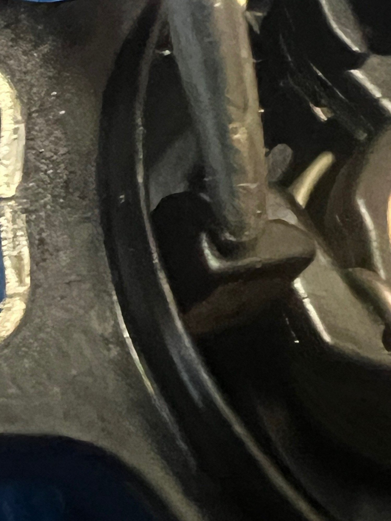

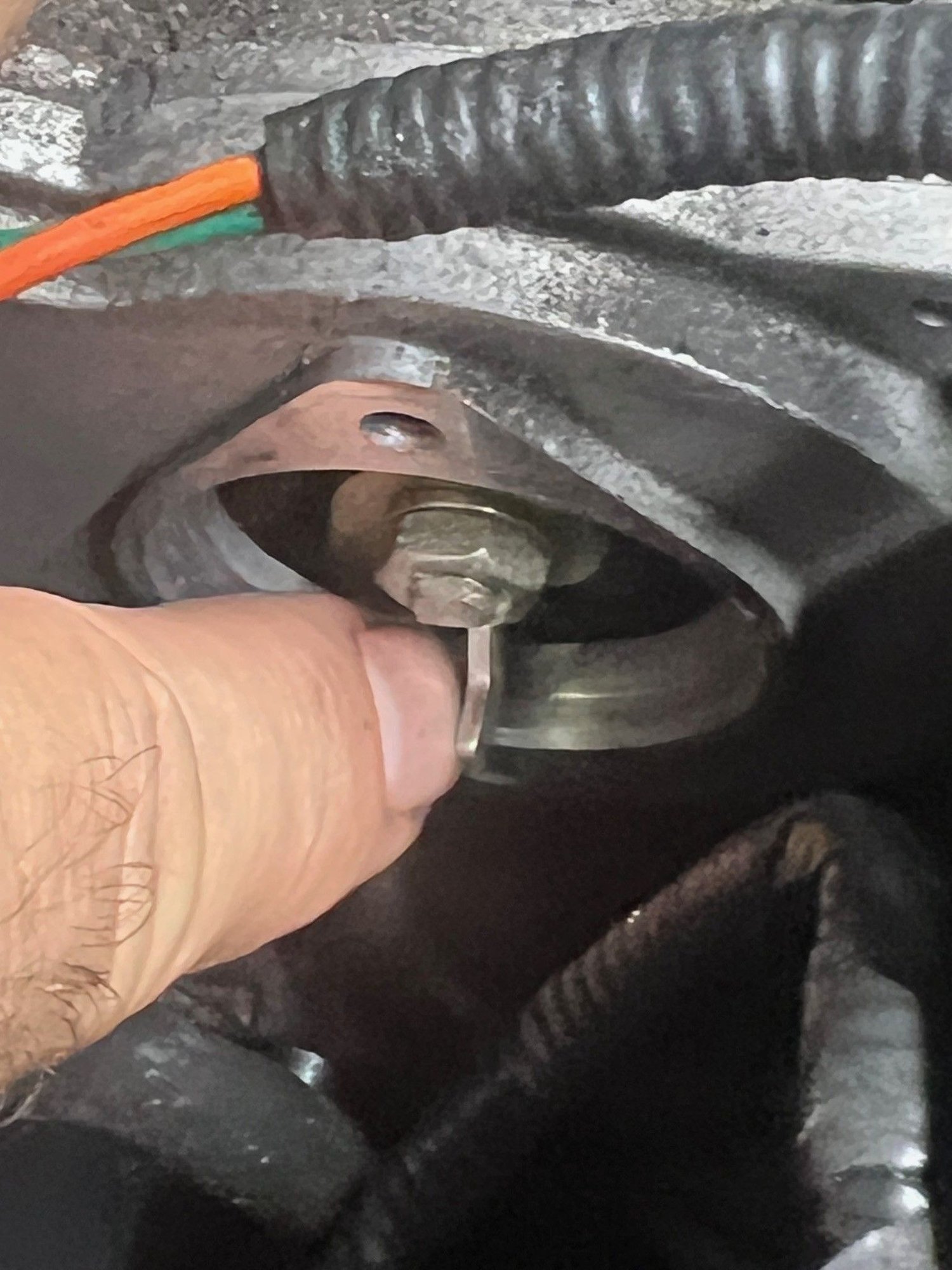

2003 XJR. With old TPS, live data absolute throttle position 0.0% rest and 5.9% floored. New TPS 3.9% rest 68.6% floored. Hooked scanner up to my XK8 and results 3.1% and 100%, With new TPS in, starts up and bounces off 3000 rpm with no pedal input. I think that is the rev limit when in park. Interestingly no more restricted performance/fail safe.
Before started attacking this issue car would go between running like a bat out of hell and then go into restricted performance and run at maybe 1200 rpm in drive with no pedal input.
Further mistifying is intermittenly (with key on) butterly does not move with throttle application. One time got a pending P0122 throttle/pedal position senson/swith 'A' circuit low.
Does live data absolute throttle position come from PPS or TPS?
I'm think I put the new TPS correctly per pictures below.
This is original TPS. Could see wear marks on black plastic so side of metal tab my nail is touching in prior picture is slid in on side below metal pick.
