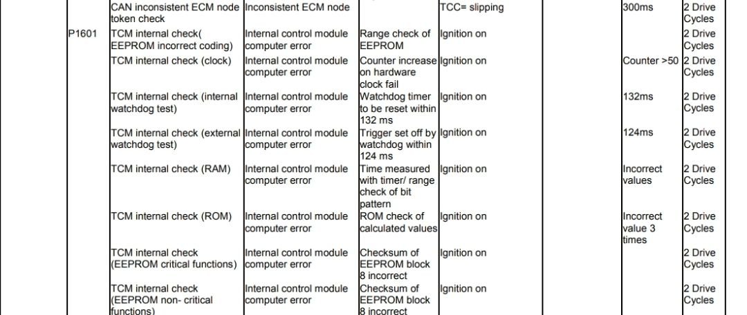

Hello beautiful people with jaguars. My names andreus, and I recently ran into a beautiful 99 XJR with 103k miles. It was kept in a rural spot so clearing the codes wasn't essential. Fortunately it has just one. Unfortunately for me, it's a pretty extensive code. Could be an actual fault, or it could be electrical from what I've gathered. I bought a Chinese mongoose but unfortunately, I had very little success actually connecting to the car. I cleaned all the grounds and charged the battery (came with a battery charger, guy had a collection) but to no success. I took it to a local specialist and they said they believe it's the Jgate, and want more money to further diagnose, but not fix. Would resetting the ECU get me closer? Or do you think that they're right? Unfortunately, they don't talk with enough confidence to reassure me that they're doing a good job. The car is also throwing an ABS and traction control light, but it's not essential right now. Right now i want it registered and on the road, bare minimum.
This is what i found as far as what to do inside IDS/SDD. Seems like this is what they want you to do, but this isnt close to what the specialist recommended.

Here's some extra information I pulled on this specific code.

oil can wick up the harness into the tcm. i’ve done sprinters where the TCM is literally overflowing.
1601 is a checksum error, the dual linear is just a range sensor and usually throws a 0705 when it kicks the bucket. you can even test it by just unplugging.
or just replace the TCM, takes 5 minutes tops and super low failure item. fire the parts cannon and ebay return if it doesn’t work out.

No leak, and clearing the codes fixed it i guess. I do have some new codes relating to the map senor and some low input codes. So technically the problem originally mentioned was resolved through clearing the codes. P0171 and P0174 ( relates to lean mixture in banks 1 and 2) I'm assuming it's a MAP sensor but I'll figure it out. Thank you guys for the help! And the dual linear switch works beautifully
