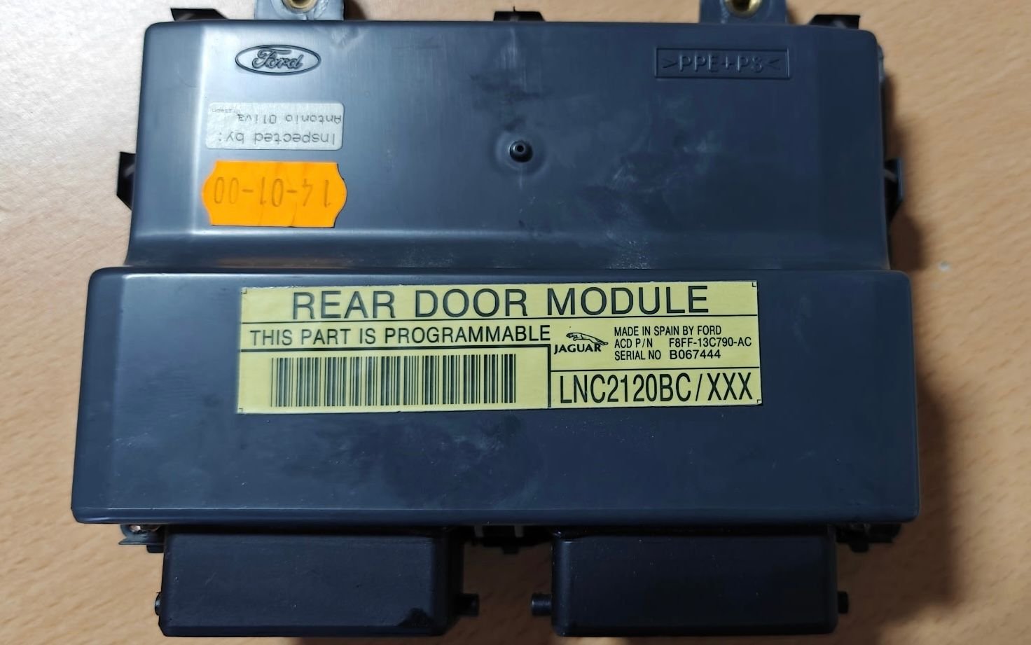

That’s interesting because they said that the module itself has a label on it that says “This module is programmable”. Why would a module that didn’t need to be programmed have that label?
I guess I’m have to go over there and see for myself.

If the door module is from another X308, it'll work on your car without programming. I would at least have a matching part number. The VCATS label in the trunk will have the P/N for the drivers door module (DDM) following a 3 digit suffix. In my experience for DM’s, as long as the P/N is the same it doesn’t matter if the suffix is different.
What is the actual problem you’re experiencing?

The rear passenger door window will not open it close AND the same door will not lock or unlock.
So what’s the significance of the XXX in the part. Does that mean I can buy any part that matches the first set of digits or must I buy one that ALSO has the XXX in the last threer?
This picture is of MY module.

You could try plugging and unplugging the door module a few times following a hard reset to see if it'll start working again. If you look closely at the male pins inside that module, you’ll see that the witness marks don’t go down all the way.

Thanks. I ordered a replacement just in case I couldn’t get mine to work. It looks like this…

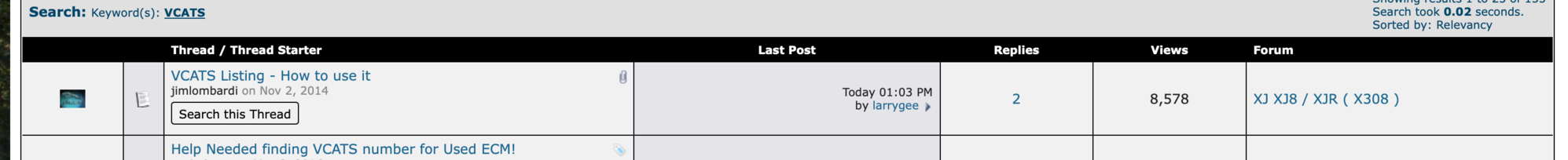

It means "Vehicle Configuration And Test System"
I found this very simply using the forum search tool, so maybe a teaching opportunity!
The search option you want
The search option you want "Search this forum"
Enter what you want to look for, in this case VCATS
Then click on the link that comes up.
