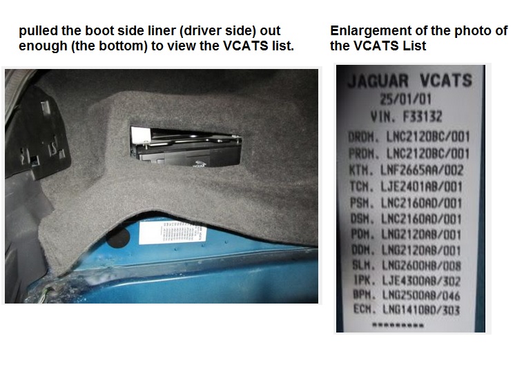

After looking at our VCATS (Vehicle Configuration And Test System) List in the trunk, I wanted to learn more about it.
In the following 2 JPEG files are a sample VCATS listing showing:
the abbeviations for the control modules listed along its control module (part name).
Also a photo showing the VCATS location in the trunk (boot).
The VCATS Listing gives the Control Module abbeviation, then its part number, then its program revision number (suffix - ie /008) in the following example:
SLM LNG2600HB/008 --- SLM is Security Locking Module, LNG2600HB is the part number, /008 is the program revision number.
Also here is a PDF file on TSB 418-03 AM that has more detailed information on the VCATS:
https://www.jaguarforums.com/forum/a...patibility.pdf
