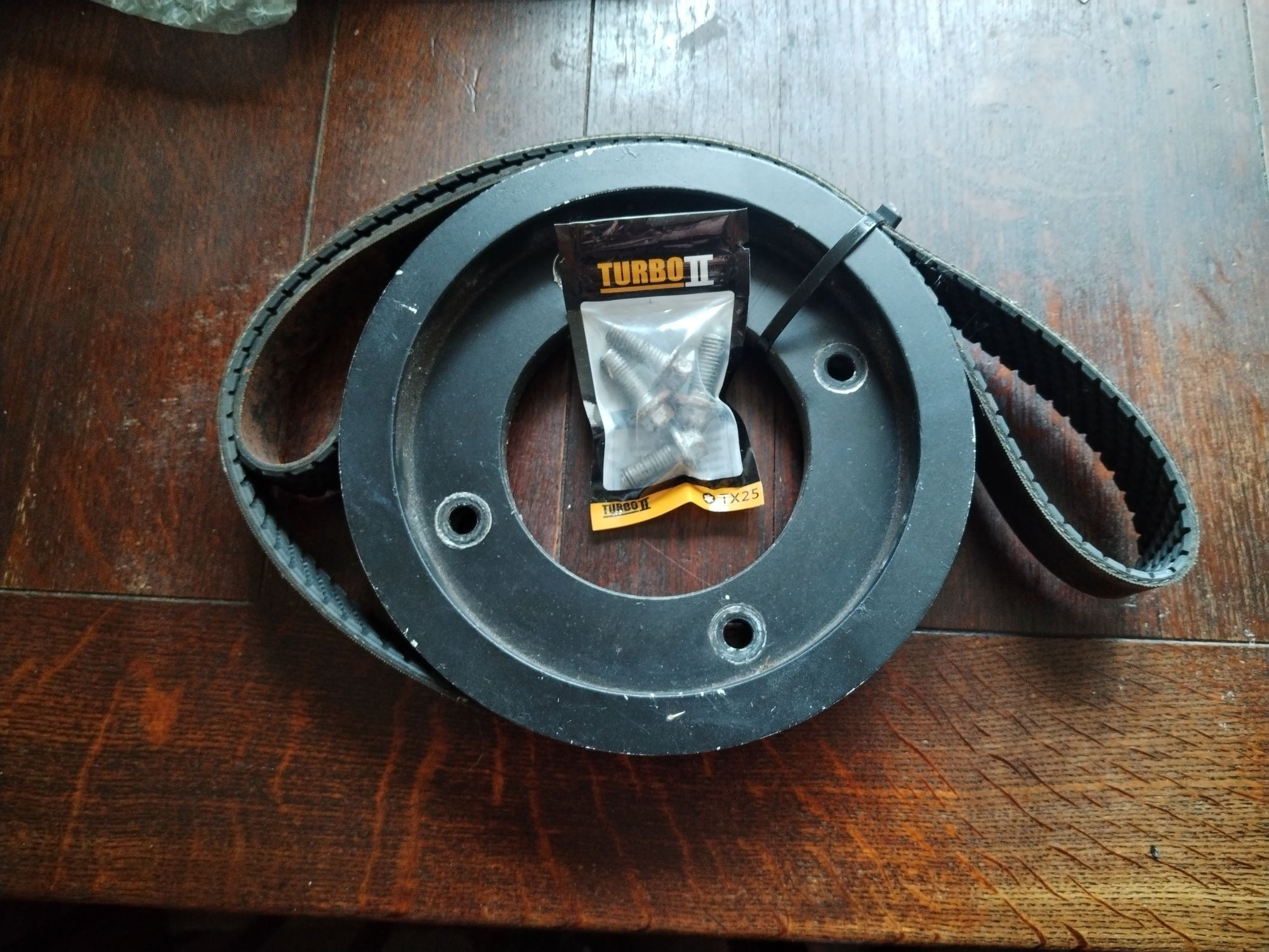

I tried that & couldn't tell, guess I'll find out as this arrived from Sean B today.
I'll have to get the uprated pump ordered & then book it in for all the work I want done. Should be ready just in time for cold slippery roads I can't drive it fast on anyway!
