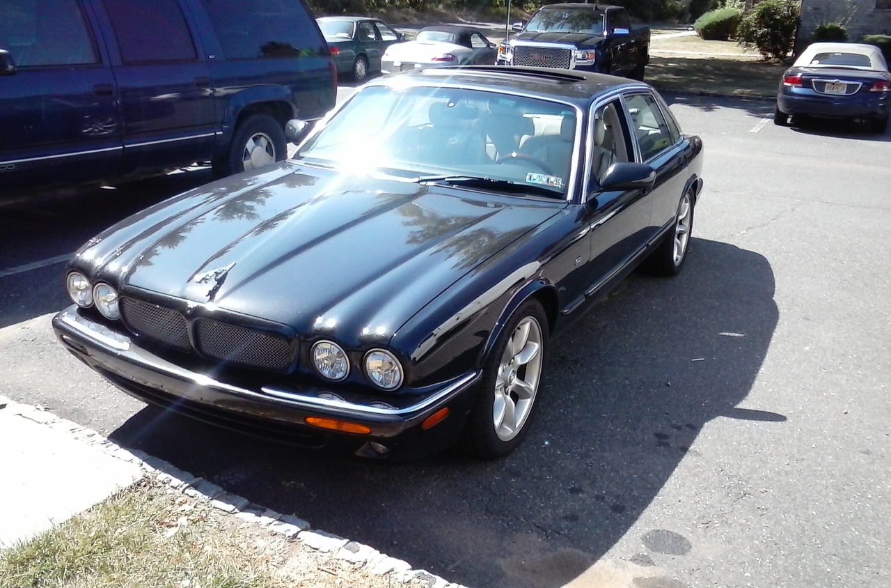

I went to see the black XJR again today, in the sunlight. I also took it for a bit more involved test drive down some winding mountain roads and on a couple of short straightaways. It's certainly not perfect, and it will probably spend a couple of weeks in my garage before I start driving it regularly; but I have decided to adopt it!
The seller is out of town, so his son met me for the test drive. I called the seller afterwards and made him an offer. He hesitated, but said "it sounds like it is going to a home where it will be well taken care of, so OK".
He is meeting me on my next day off (Wednesday) to complete the transaction. I will be bringing her home Wednesday night! Once she makes the 90 miles to my house, she will get thoroughly fixed up.
I am now enthusiastically ordering parts, so any recommendations are welcome. I am leaning towards Akebono pads with Brembo rotors for the brakes. Do you think if I painted the calipers red it would be lame? haha. I think with the silver wheels and black car it would look cool.
I need to order transmission fluid, too. I am a fan of Valvoline, but really like the idea of the "kit" from ECS tuning (I bought my BMW wheels from them). My only hesitation is that I haven't heard any opinions on the Febi fluid.
Is the Victor Reinz VS50397 Valve Cover Gasket Set a good product?
