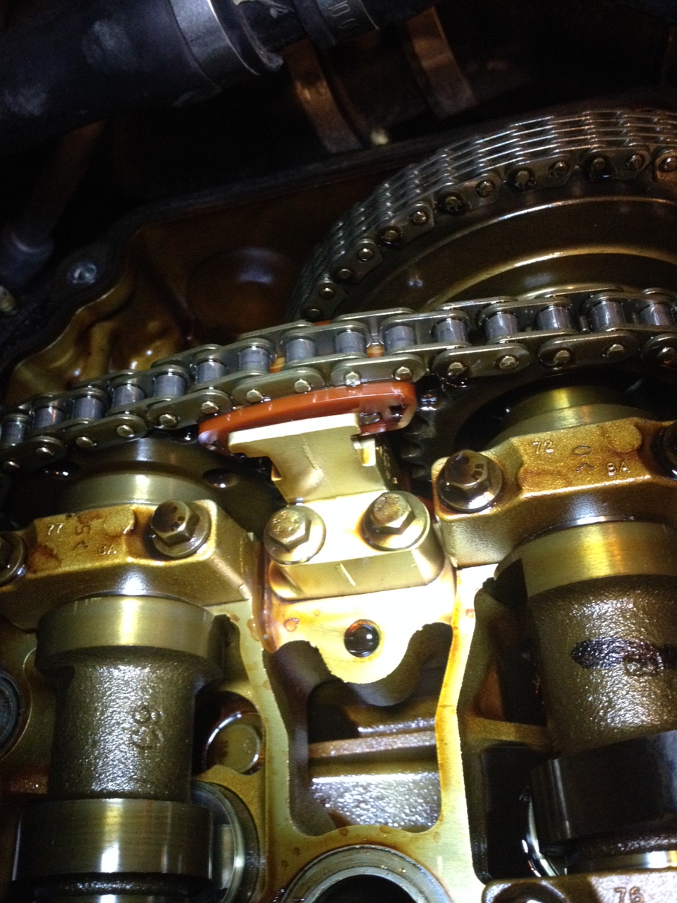

Incidentally, the below picture is a welcome sight when buying a used X308!

The OEM Jag parts look much nicer than the aftermarket tensioners

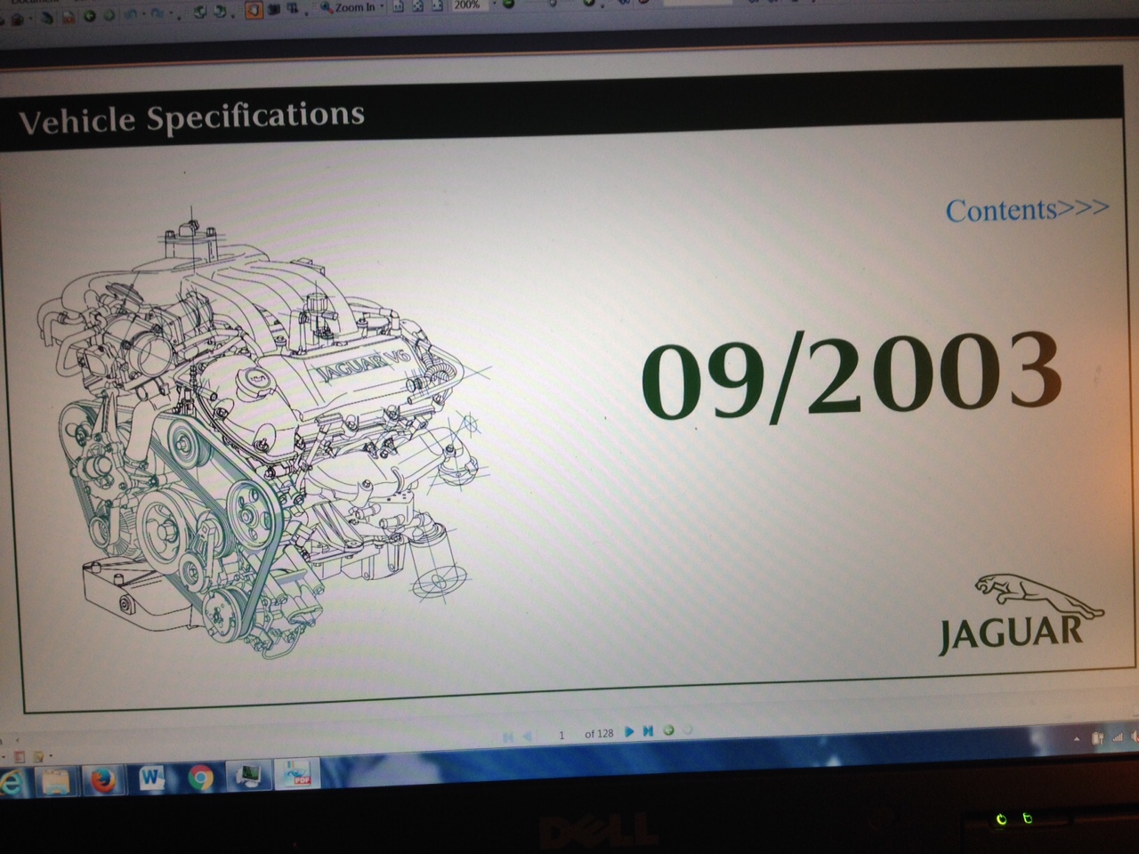

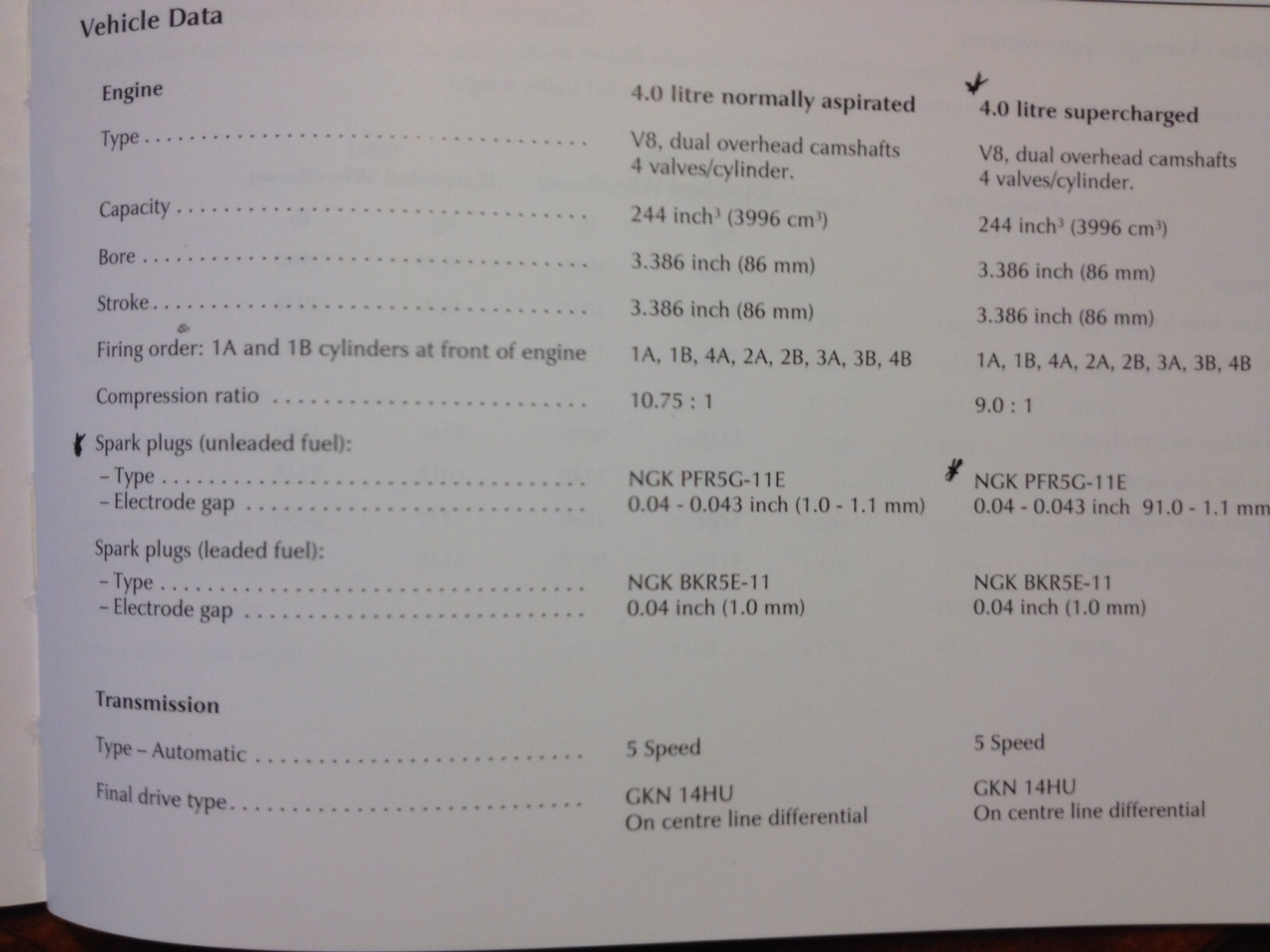

Yes, whenever I search non-Jaguar databases the plug comes up a 6 heat range. I am attaching a picture of my owners manual page listing recommended spark plug. It lists a double platinum plug, the NGK 7866 I believe is the Iridium equivalent.
I am also attaching a picture of the cover page and then spark plug page (17) from the Jaguar manual from the year my car was built. It lists AJ8 4575 for my model and year, which is a direct cross-reference to the NGK 7866.
I don't know why so many current sources recommend a different plug!

Interesting. So Jag says the 6 up to 2000my, then the 5 from 2000my
My 98 manual shows the 6.
