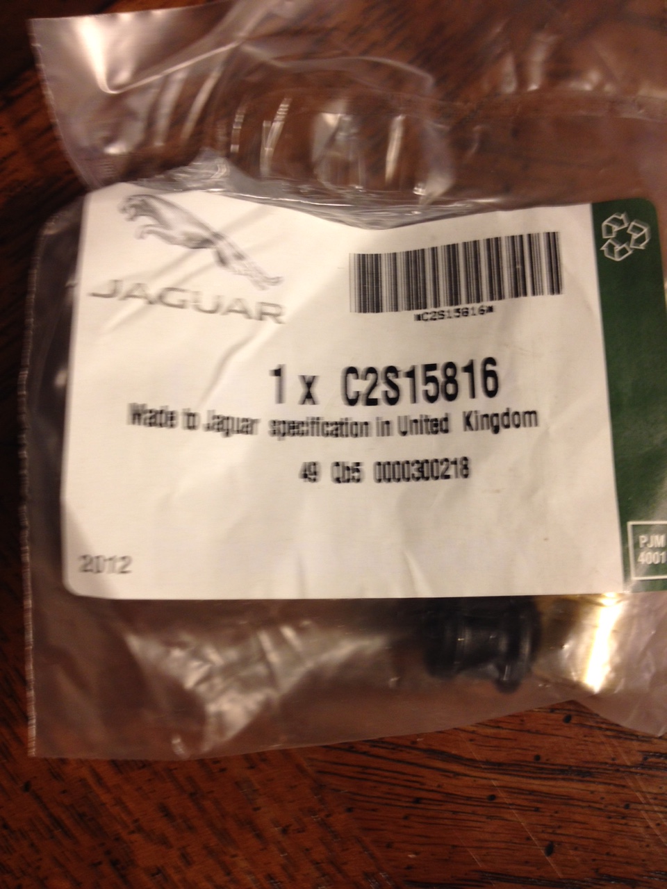

The vacuum leak is most likely from the brake servo/booster line where it joins into the 90 degree elbow below the throttle body.
The rubber O ring in the quick connector fails, You need part number C2S15816, I believe it is for a V6 X type ( it is the same fitting as on an X308, but you have to buy the whole elbow for a X308 ) fit the new black plastic fitting onto the pipe, remove the O ring from the brass fitting and fit into your existing brass fitting, plug the hose back in.
The fitting was less than £10 from my local Jaguar dealer, so about $15-$20.
Your alternator is not humming when your ignition is turned on, that is the aux coolant pump. It is an inline electrical pump that circulates the coolant from the charge tanks on each side of the SC to the intercooler in front of the car. It runs when the motor is running or the ignition is turned on. It is essentially a separate coolant circuit from the main cooling system, but they join together on a couple hoses for expansion, ect.
Look what I just happen to have in my toolbox still in the original bag. I ordered it a while ago for one of the other cars and ended up not needing it. I think I will replace that fitting, as you suggested Andrew, before I even run the smoke test.
So is the installation as easy as it sounds? I simply pull the old line out, replace the plastic fitting and O-ring and push it back in? Is there much risk of anything breaking in the process?

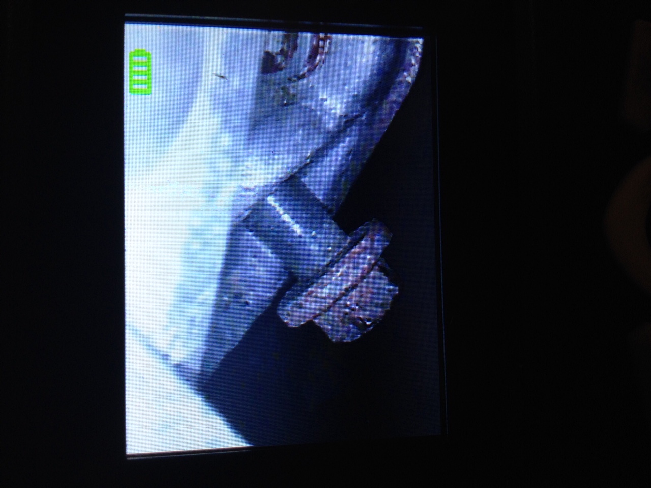

I finally got around to performing the smoke test, and amazingly that brake booster connection is not leaking. The EGR valve connection is leaking. I am having a hard time figuring out exactly what needs replacing, but there is a connection going from the EGR valve towards the engine, it looks like metal to metal with a gap and smoke pouring out. There is what appears to be an untightened bolt there, but I was afraid it was an adjustment bolt of some sort so I didn't mess with it.
I tried to take a picture of the inspection camera screen but it just didn't work.
Attached are pictures of the bolt that looks precariously loose, and the exact location of the vacuum leak (which is directly behind the bolt).
I have yet to find a way to get a wrench on that bolt, even if I was planning to try tightening it. I guess I should order all new EGR gaskets and a Throttle body gasket and then take it all apart to clean and re-assemble.
