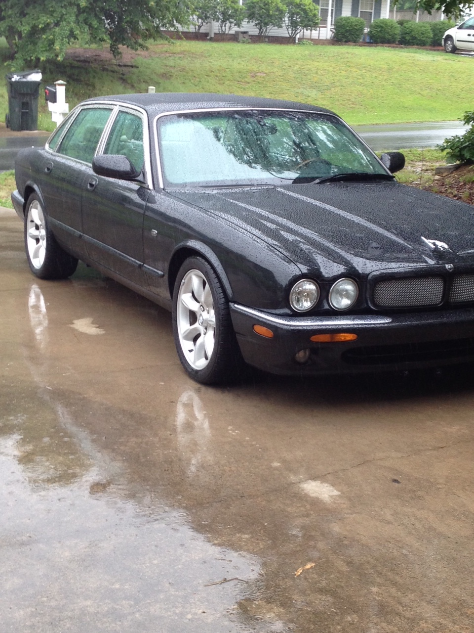

Side note. I love the way a black car looks in the rain...
As I don't drive the XJ8 that often, I up the pressure sometimes for the longer 'standing' periods, and it is very noticeable if I take her for a quick drive.
Yeah, she looks great.
I am always even more amazed how different the x308 looks with different wheels, especially concave ones.
Did you ever sell your XJ8?
Thanks Eric,
The wheels are among my favorite Jaguar ever offered, which was a strong selling point for me on this car.
I sold the XJ8 about a week after I picked up the XJR. It worked out really nicely. The XJR was in my garage for about a week undergoing an extensive list of maintenance items before I was willing to drive it daily. During that week the XJ8 was still serving as my daily commuter. Within about a day of rolling the XJR out of the garage to take over my daily commuting, someone handed me a cashiers check and drove away in the XJ8.
