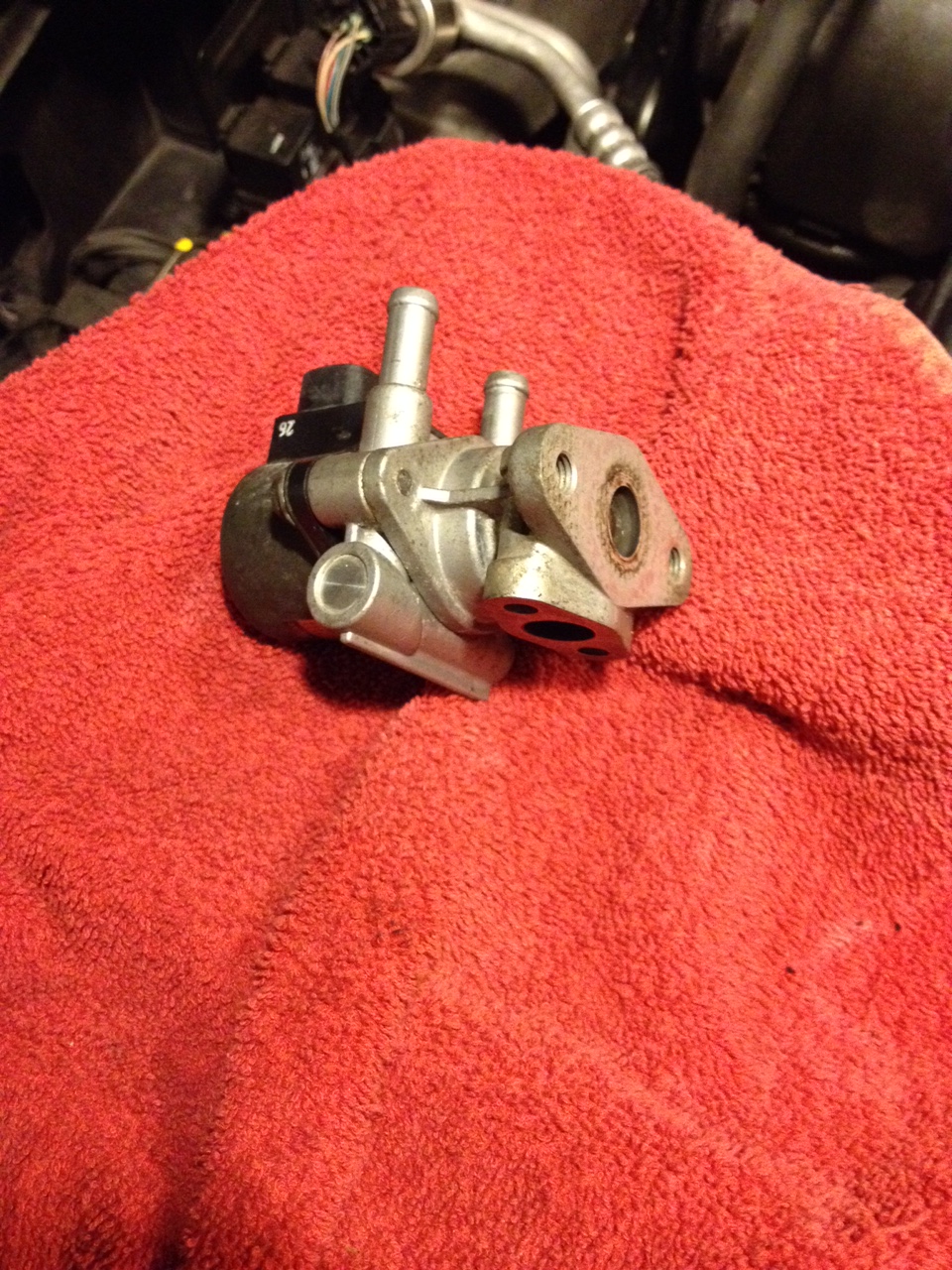

Currently I have the throttle body and EGR valve removed to address a vacuum leak. I am awaiting todays mail so that I'll have my gaskets and can put it all back together. The two screws that hold the EGR connection to the throttle body adapter (where it was leaking) were VERY loose. In fact, if I had only tightened those it may have eliminated the vacuum leak and not required disassembly. I am glad I did take it apart however because I got a chance to thoroughly clean it all. The port in the throttle body adapter where the EGR valve connects was the only place with heavy buildup. It took a long time to clean all the buildup that was partially occluding that air passage way.

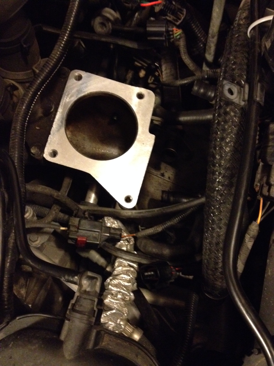

Despite adding two new upstream oxygen sensors and repairing a nasty EGR valve leak, I am still getting high positive fuel trims at idle and while coasting. I have ordered a new OEM Jaguar coolant temperature sensor because I have my doubts about the accuracy of the one on the car (entire additional post needed to explain) and because it's a critical sensor.
I did a more thorough round of smoke testing tonight, actually wrapping my air filter in cellophane to cause a bit more pressure for leak detection. I had a very large amount of smoke coming out in the vicinity of the passenger side (RHS) valve cover. Using an inspection camera I ruled out the edges of the cover itself. I removed the coils and insured that the spark plug seals were not leaking; they were not. I strongly suspected the connection between the MAF and the intake going to the throttle body. I took it apart, cleaned the seal thoroughly and re-assembled; leak was the same. It was VERY hard to see where the smoke was coming from. Finally, I wrapped a shop towel around the connection between the full load breather hose and the intake going to the Throttle body, suddenly the smoke flow was interrupted. It was pushing out the bottom of that connection and blowing an impressive amount of smoke down towards the valve cover. I tried and tried cleaning the 0-ring, but I could not get a satisfactory seal. I will order a new full load breather hose tonight, they are not terribly expensive.
I wish I knew a way to temporarily eliminate the leak until the new hose gets here.

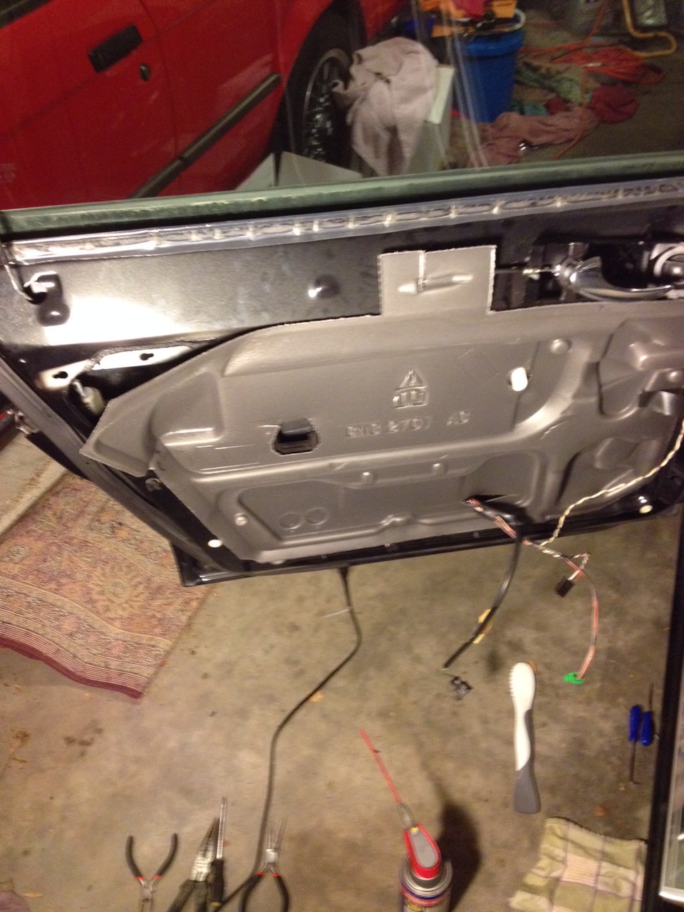

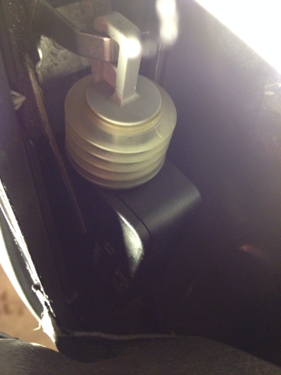

I decided to tackle the rear door locks tonight. I successfully removed the door card on the rear drivers-side door (RHS). The actuator would NOT lock, it was jammed. I pried up the small protective boot and sprayed lubricant down into the mechanism. Voila, not it can be manually locked and unlocked! But, no such luck with the FOB or lock buttons in the car. You can hear, and feel, the movement inside the actuator, but the mechanical portion does not move. Apparently it's broken or disconnected inside. I guess I have to source two rear door actuators. Anybody got a parts car I can purchase from?
I went to the heritage site, where I generally get all my part numbers. I cannot find the actuator motor for the rear on there so I'm having trouble searching for the replacement unit.

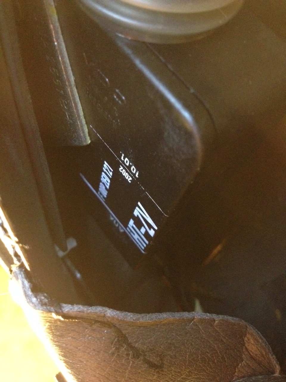

I had the rear of the car off the ground last night to replace the anti-sway bar bushings (took all of 20 minutes). While I had some ground clearance, I slid under the driver side (LHS) just behind the front tire and snaked the inspection camera just above where the steering column attaches to the rack. I think I could have actually seen the number without the camera once I knew where it was, but it was much easier to read using the lighted camera.
My car manufacture date is March of 2002, so a Feb 02 engine date could make sense. When I replaced the door handle assembly (thanks Convincor for the parts) I noticed the date on the old door handle was November 2002. I have seen various components throughout the car dated throughout the entire year of 2002, even thought the car was supposedly assembled in March of 02. I am guessing maybe since it is a 2003 model they assembled the frame in March and the rest of the car came together throughout the year?? I don't know. I guess it doesn't matter really. I have SEEN the timing gear and it's beautiful, so beyond that I the dates are irrelevant, haha.

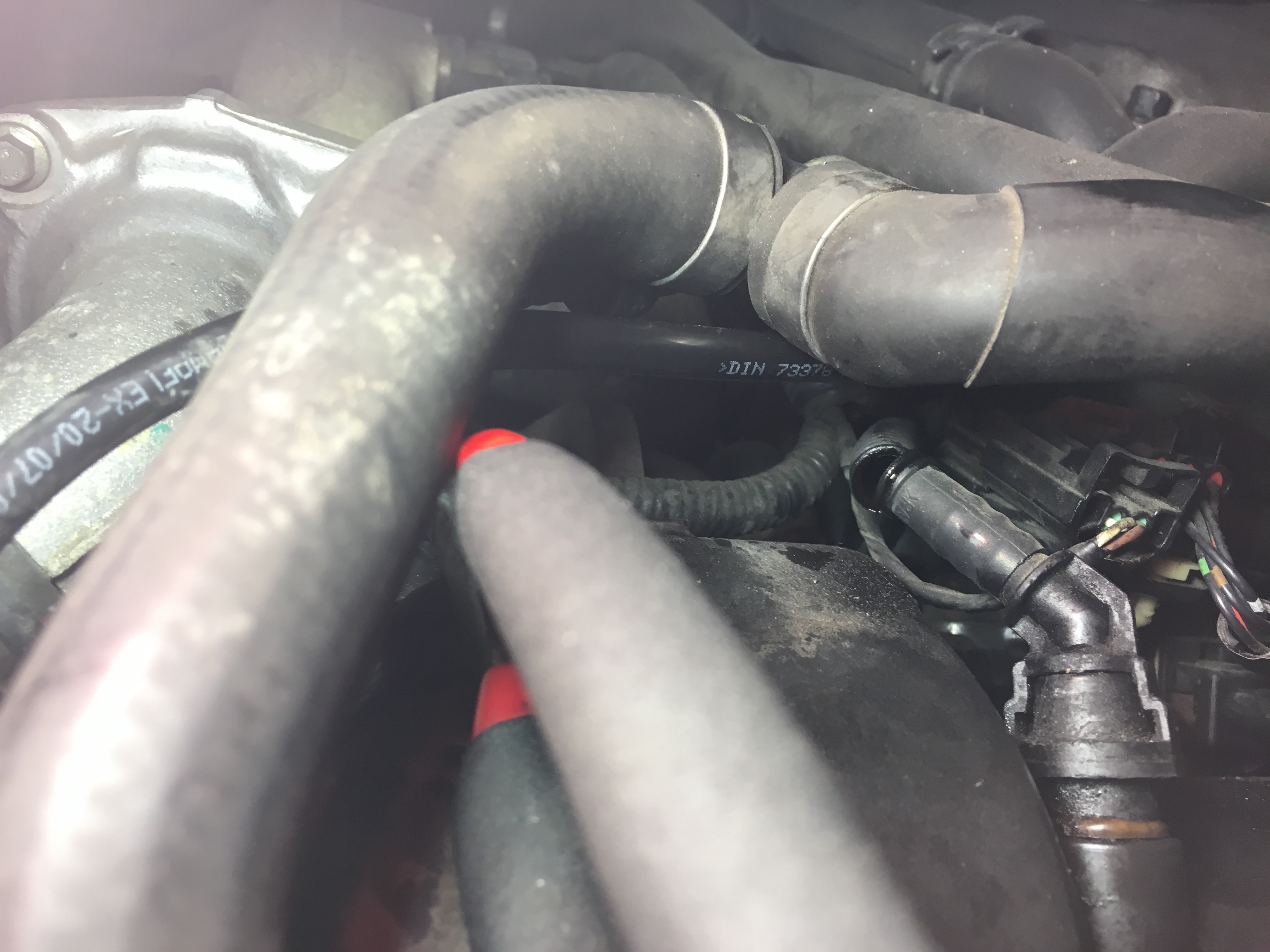

Default broke a hose
Hey Jeff, perhaps you can help me here. I broke a hose while trying to replace my valve cover gasket, I don't even know what it is or where is it even connected at the other end. Can I just wrap this up while I drive to get a part from Jag dealer?

Part load breather tube. Wrap it up but get new.
Jag part # aj84879

Thanks Convincor, where is the other connected to? Is it hard to replace?

Maniqz, I did the SAME thing when I bought the XJ8 last year. I ordered the part online, I think it was between $30 and $35 dollars.
I had to snake it under the manifold on the XJ8, but you have an XJR if I'm not mistaken, which means it must go underneath the supercharger. I tied a string to the old one and pulled it out as it pulled the string underneath, then I loosened the string and tied it to the new one and pulled it through and into position. It was not as easy as it sounds, but it worked.
I am out in the garage replacing both fuel pumps. I just got the tank back in the car and am hooking everything back up. Major prayer time! haha. I really hope I did everything right.

The other end connects to the throttle body.
Would have to look and see how it's routed. Don't recall..
