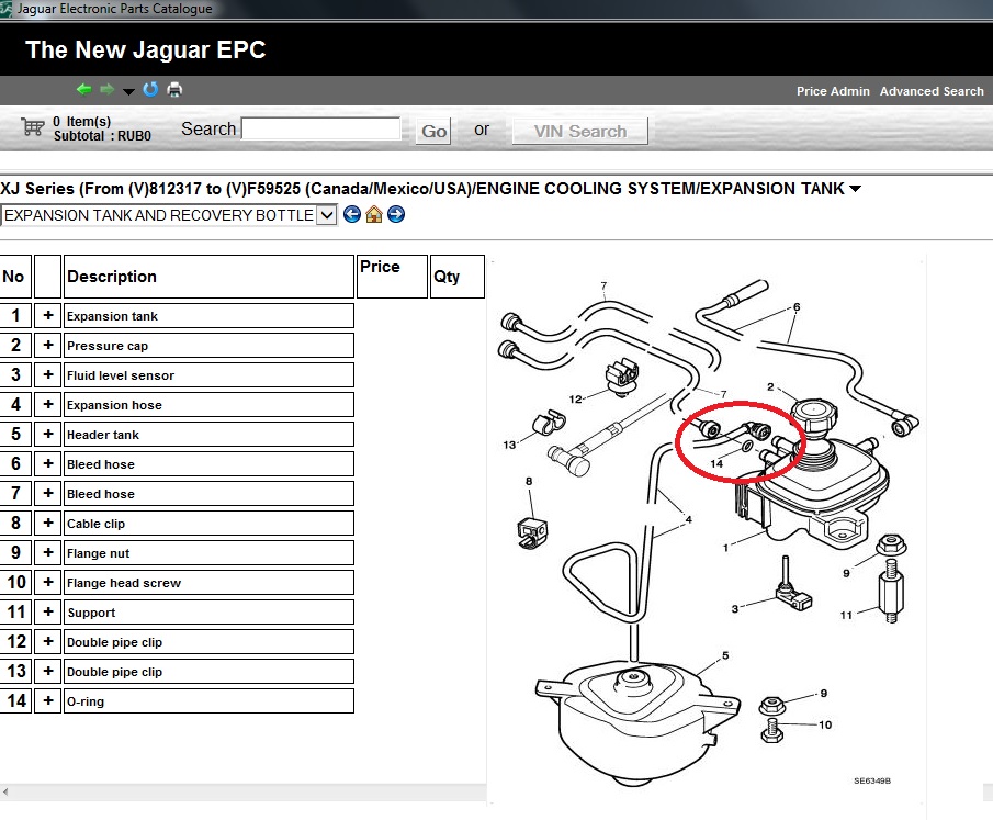

But are they connected the right way round on the Expansion Tank? LH (Bleed Hose - item 7) to Radiator and RH (Expansion Hose - item 4) to Header Tank. It's very easy to get them the wrong way round.

Wow - the Radiator has had a good thump! We have different interpretations of a chip/scratch.
It can be difficult to trace the source of a coolant leak because it can run along pipes etc before dripping on to the ground. A pressure test often helps to pinpoint the source.
