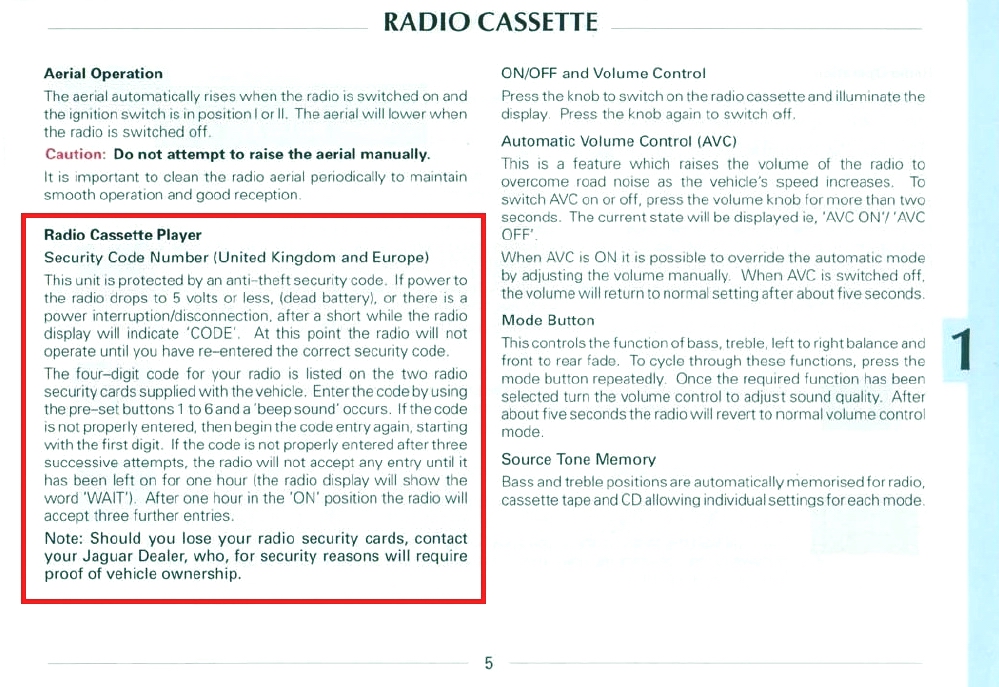

Further to this, I recently needed to enter my radio code, which I did, now all I'm getting is a "wait" sign....do I have to press anything else after the four digit code?
Old Feb 22, 2013 | 03:26 AM
Likes: 17,010
The WAIT message appears if you enter the wrong code three times.
The radio has to be powered ON for one hour before you can try to enter the code again.
By powered ON, that means ignition ON or engine running for one hour and not just leaving the radio in the switched ON position.

I just call any Jaguar dealership (besides this local one who dont seem to have any anyformation about Jaguars besides selling news ones). I usually use one in Atlanta. They just ask for VIN number and they supply correct 4 digit pin for that car. This is assuming thta is the original radio that came with the car when new or else you'll have to pull the radio out and give them the numbers from the radio tag that is on the back. Takes about two minutes to retrieve info and 30 seconds to put in. Once the digits are entered correctly, the radio should just come on. Mess aroudn and get it wrong three times, it will say "wait" for very long time (about 10-15 mins) or until battery is disconnected again within that time frame.

The WAIT message appears if you enter the wrong code three times. The radio has to be powered ON for one hour before you can try to enter the code again.
I have also found that if you disconnect the battery (negative lead) for a few minutes you can try over again straight away.
